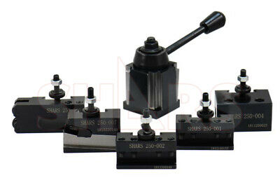

I planned to upgrade tooling soon, but wasn’t sure what to get. Thanks for the tip! High on my list is a QCTP.
@Todd_Fleming they are nice but the holder you are using would probably be more rigid. That’s the issue with the aluminum QCTP I have. I should make a heavier steel one.
Maybe this one? Steel: http://littlemachineshop.com/products/product_view.php?ProductID=4039&category=1963256890
@Todd_Fleming that is a wedge type which is considered much better than the older dovetail system that I have. I bought mine from LMS years ago before I knew better. They discontinued my version. I’ve seen this same wedge quick change in eBay for a few dollars cheaper.
I think the Shars might be a better version. They are a larger industrial tool store.
