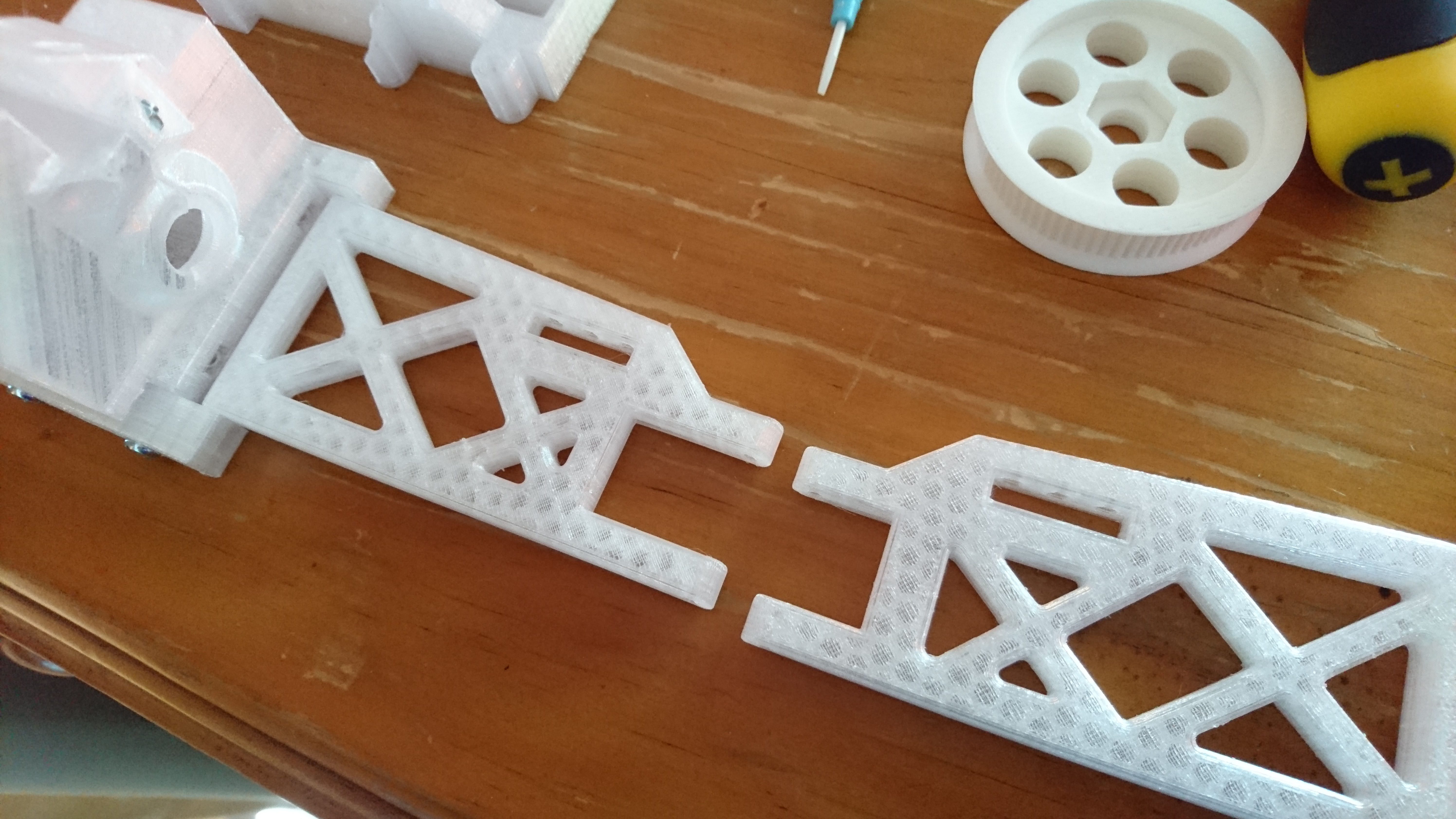

Getting my print on. Taulman Tech-G, .4mm nozzle, .2mm layer height, 2 perimeters and 2 top/bottom layers. The strength is incredible!
Does make a nice looking print, what nozzle and bed temp did you use?
E3D V6 hotend. 245deg first layer, 240deg for rest. Glass build plate heated to 60deg with a coating of pva glue.
I currently run a heavily modified Velleman K8200 printer. Print quality is very nice, but a bit slow.
I really like the fact that with PETG you can see the internal structure of the parts.
I’m about to switch to Taulman N-vent in red for the rest of the parts. First time printing with N-vent, looking forward experimenting with a new material.
Anyone out there with experience with this material. It’s the same material as Colour Fab XT apparently.
