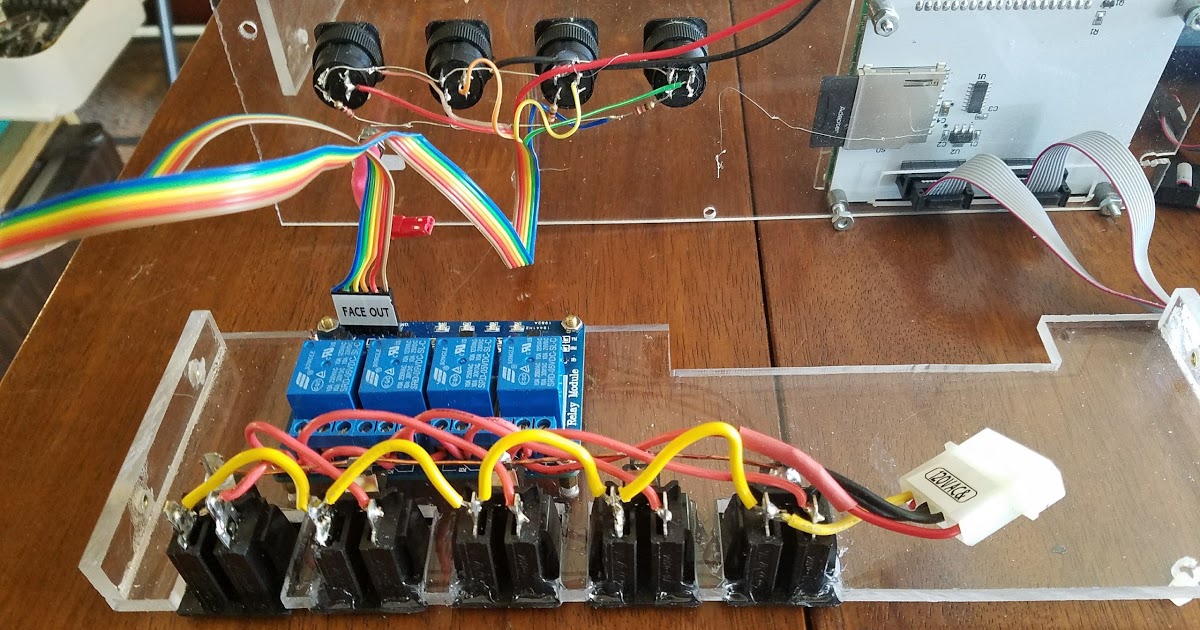

I used a relay module that is controlled by switches on an auxiliary panel to control outlets.
I set these up so that they can be controlled by software and/or panel switches.

I used a 4 relay module but you can find two relay versions.
If you need more customized version of what I did let me know.

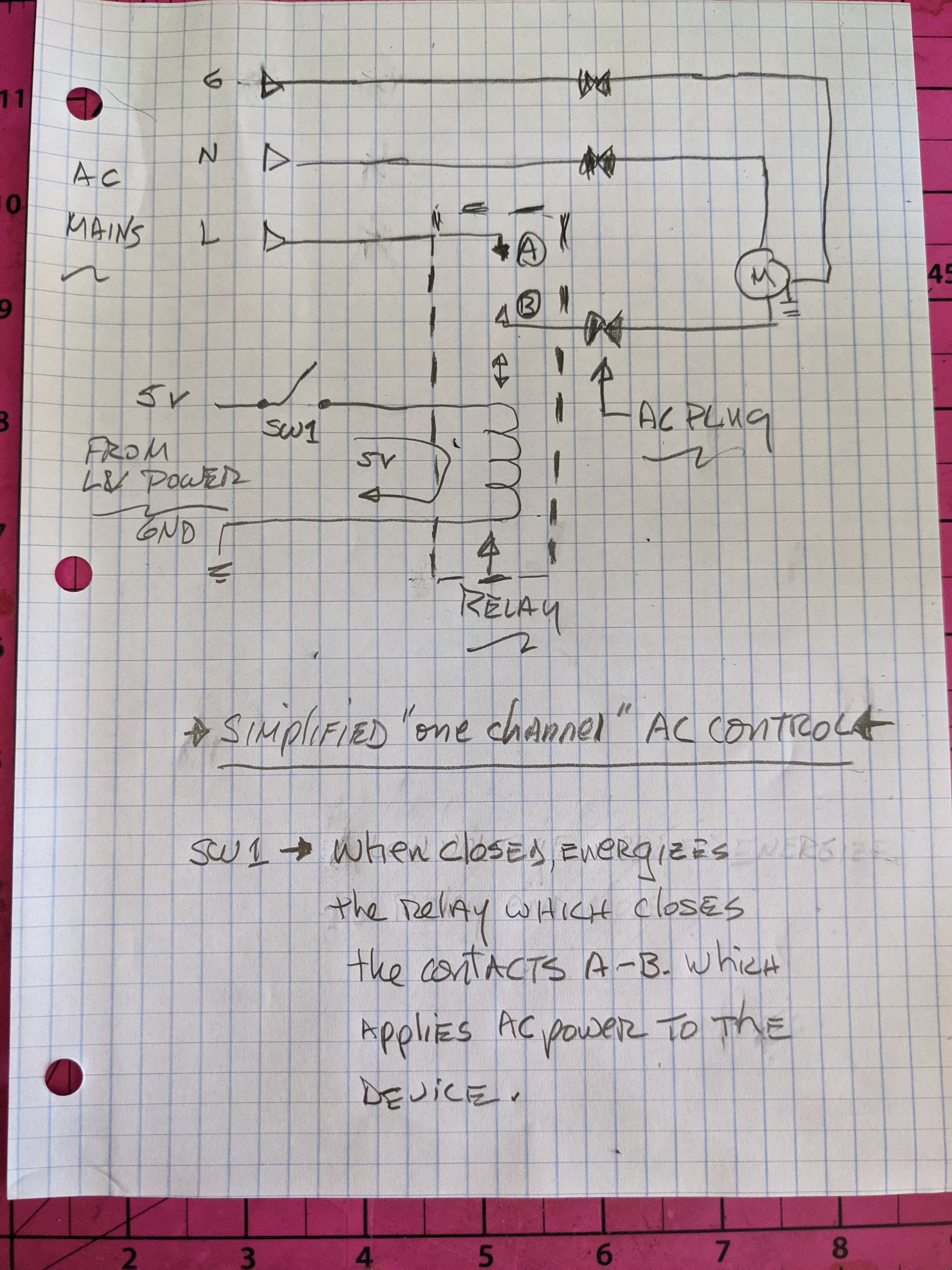

Attached is a simplified drawing of the control of one device. Mine has 4 devices yours may have only 2.
The switches like SW1 are those on the panel.

@Dkwells the drawing I sent you is NOT an actual design it was intended to show a simplified picture of how it works. DO NOT use that to actually try and wire a machine.
If you need help on the actual design let us know.

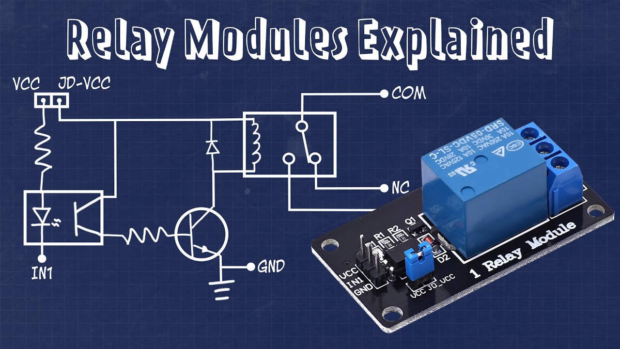

You won’t be connecting your relays to a microcontroller but this video shows how a relay module works. Try and ignore the arduino references:
Watch “K40 - How to Control AC Devices” on YouTube
