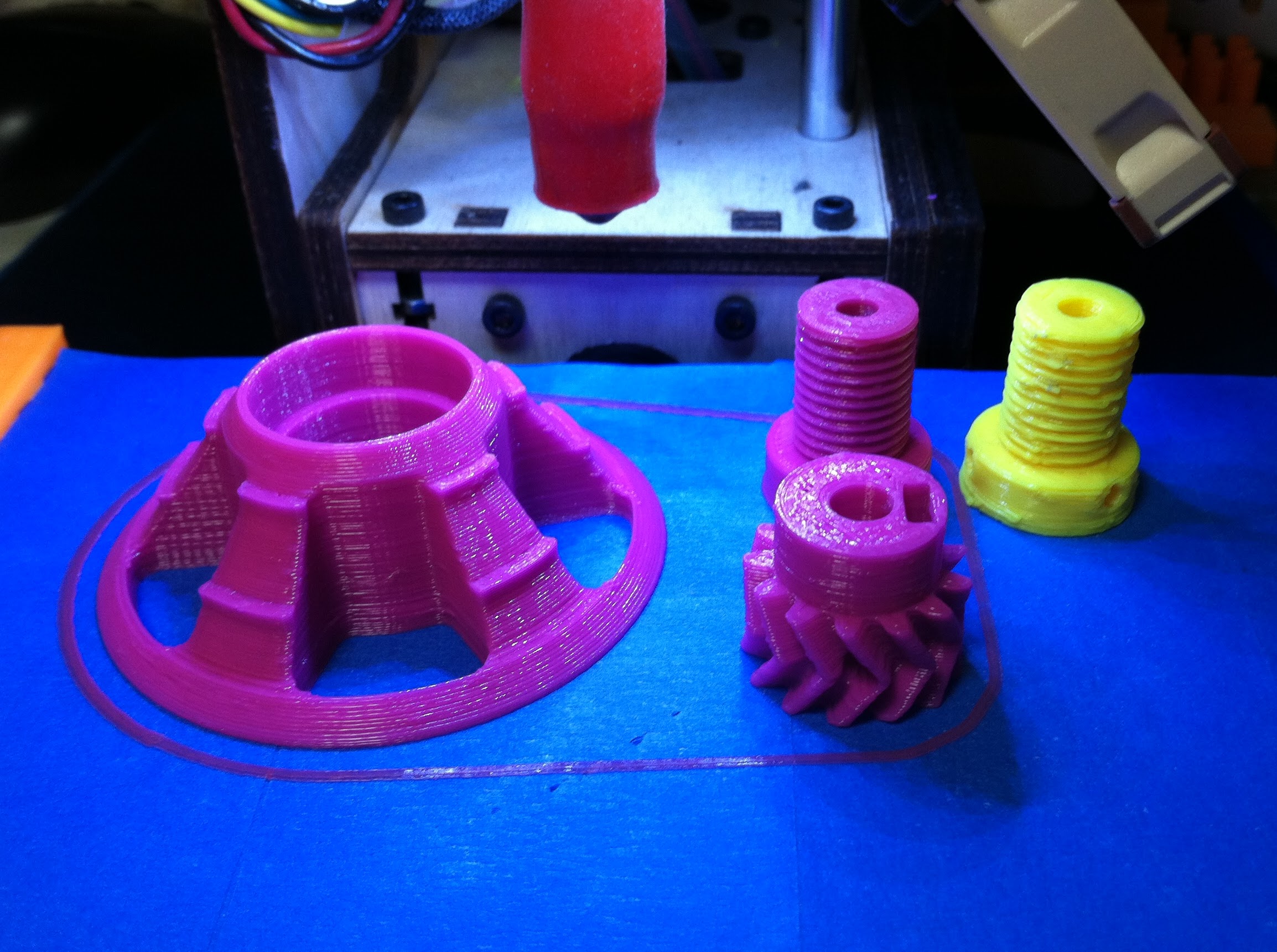

Getting some fine results off my Printrbot at 0.25mm.
Getting some fine results off my @Printrbot at 0.25mm. The yellow gear was printed a week ago at 0.3 and 2% more extrusion steps/mm. Color is neon purple.

What parameters did you tune? I’m still at yellow year stage with my Prusa i3.

@Matt_Harrington I tuned motion first - the steps/mm and then speed. Leveling is important - so I replaced the wood bed with a piece of glass. I also tried Cura and use it a lot but these gears were printed in Slic3r. Also I messed with E steps until I got parts that fit (2 layer tops look a little shabby now). Also cut down slic3r setting for over extrusion on first layer.
