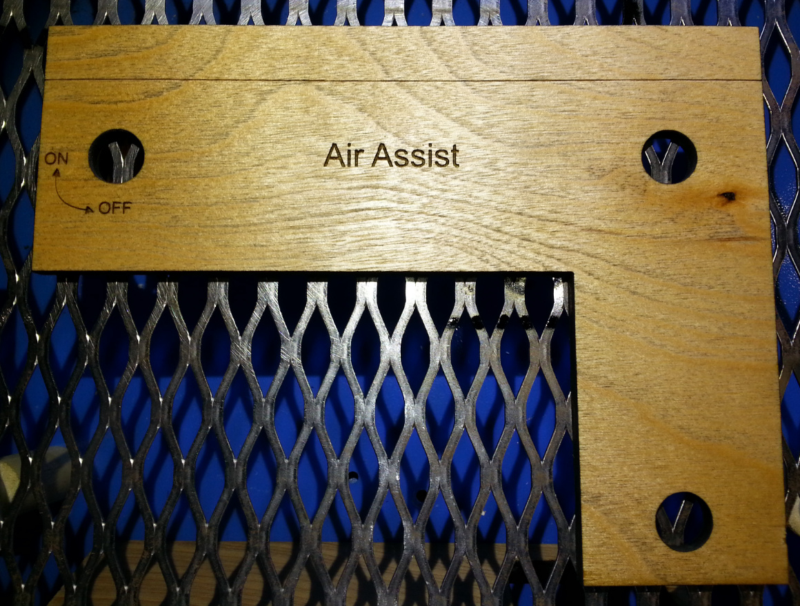

Made my first practical item today. Bought an air flow gauge off of banggood for my air assist and used my wonderful new laser machine to create a mounting plate. Cut it out of 1/4" ply. It was a great project to help me learn some of the basics of Corel Draw.
I also learned today that if you want to cut or engrave a layer the little print icon for the layer must be clicked on. Spent 30 mins trying to figure out why my cut layer would not cut
Nice job. And a practical addition to your K40.
@Nedman The layer print icon is really handy. That way you can keep your entire project in 1 file. Separate the cut & engrave sequences by layer (just like other laser software lets you do it by color) and then output one layer at a time in the order you want.
I still use colors because the other laser I use lets me use the colored lines to then set engrave/cut operational parameters (speed, power, engrave, cut, etc). I can use the same file on my K40 or the bigger 60W machine.
@Jim_Hatch Yeah that’s what I’m doing as well. Had a layer for the engraving and one for the cutting with different colors The engrave layer executed just fine but the cut layer would not execute and it was driving me crazy until I realized that the cut layer print icon was off. I’ve been using the object manager to select the items to execute, but I’m guessing I could just select all and then have the layer I don’t want just turned off.

Looks really nice.
Cool add-on for your cutter. It would be cool if your little flow gauge was illuminated

@Yuusuf_Sallahuddin_Y Great idea on the illumination. Now if only I had some LED’s… https://www.dropbox.com/s/t4lhr90w765bxr2/20160625_233211.jpg?dl=0
Oh yeah I can make this happen
https://www.dropbox.com/s/k2m7pjkutg83znj/20160625_233338.jpg?dl=0
@Nedman That’s awesome. Looks even better than I had imagined.

what pump are you using for your air assist ?
@Robert_Selvey I’m using this pump https://www.amazon.com/gp/product/B001BJFHAW with a 5 gal portable air tank to dampen pump oscillations. This pump does about 23 lpm which is plenty. I’m running my air flow between 10-15 lpm for most things so far.
I just got this https://www.amazon.com/gp/product/B002JPRNOU/ set up yesterday, which claims to be 45 lpm but it doesn’t feel like a lot of air… I have no idea contextually how much air to expect, though. I guess I’ll find out if it’s enough when I do some cutting tonight.
Can’t wait to hear what you think about the pump.
Seems to do the trick! Before, cutting = fire, now… no fire!
It’s not too loud either, well, the ventilation blower I have is so loud, everything else is drowned out…
