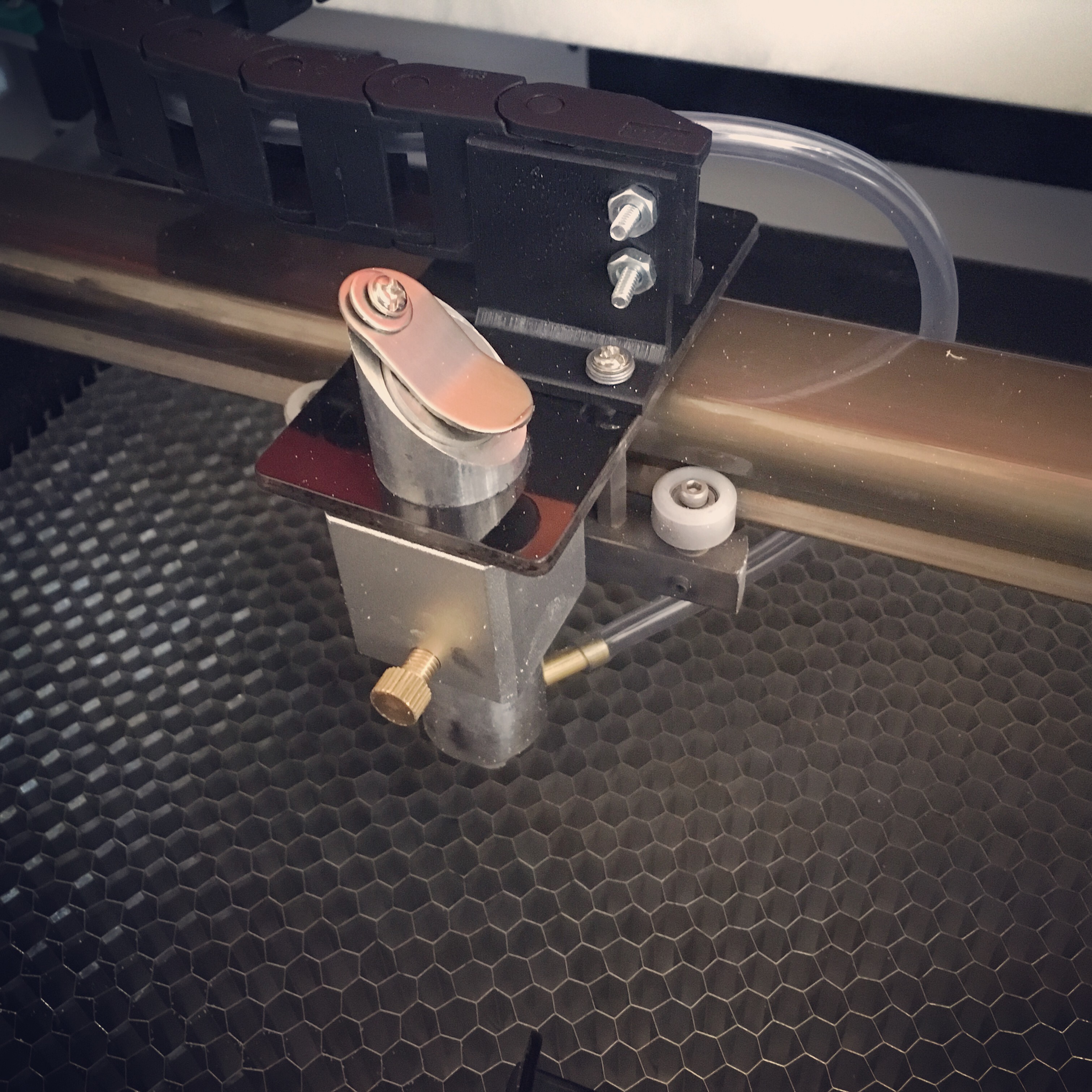

Getting there. New adjustable head, mounting bracket, mirrors, air assist, drag chain,
Getting there. New adjustable head, mounting bracket, mirrors, air assist, drag chain, ventilation and honeycomb bed. Just need to install the cohesion3d pcb and I’ll be all set.
Where did you very three adjustable head?
@Tony_Sobczak it’s from Saite Cutter on eBay. Just know it needs a 20mm hole in the mounting bracket. So I had to make my own.

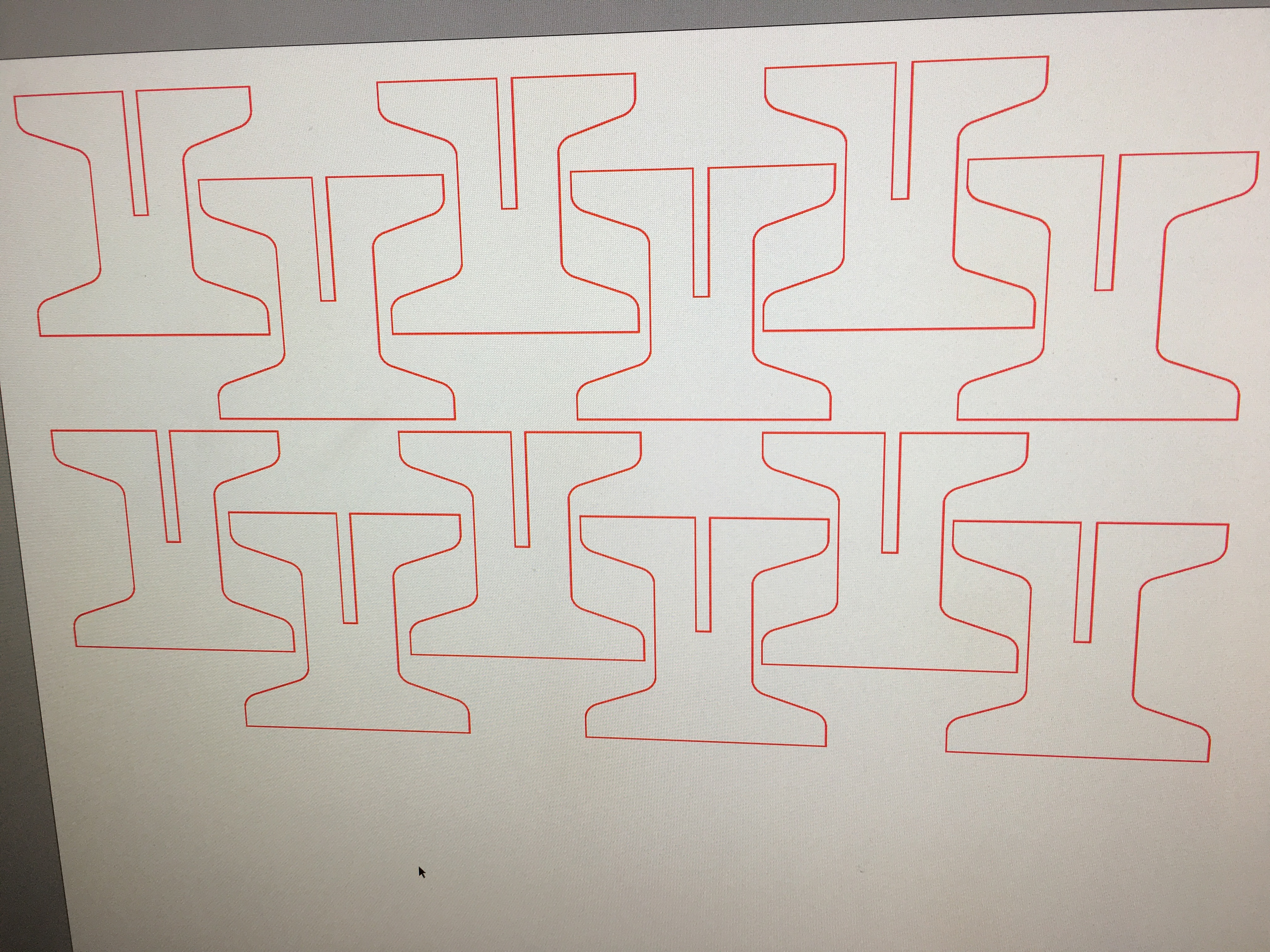

@Trevor_Boultwood The honeycomb sits on a sheet of metal grating from Lowes. Which I cut to size with metal shears. Then under it I have 6 lasercut standoffs to support the grate. Haven’t decided long term if i’ll keep the lasercut parts.
Here’s a pic of the standoff design
I’m thinking of using a cheap scissor jack off of amazon to support the honeycomb, so it will be adjustable. any reason that wouldn’t work?
