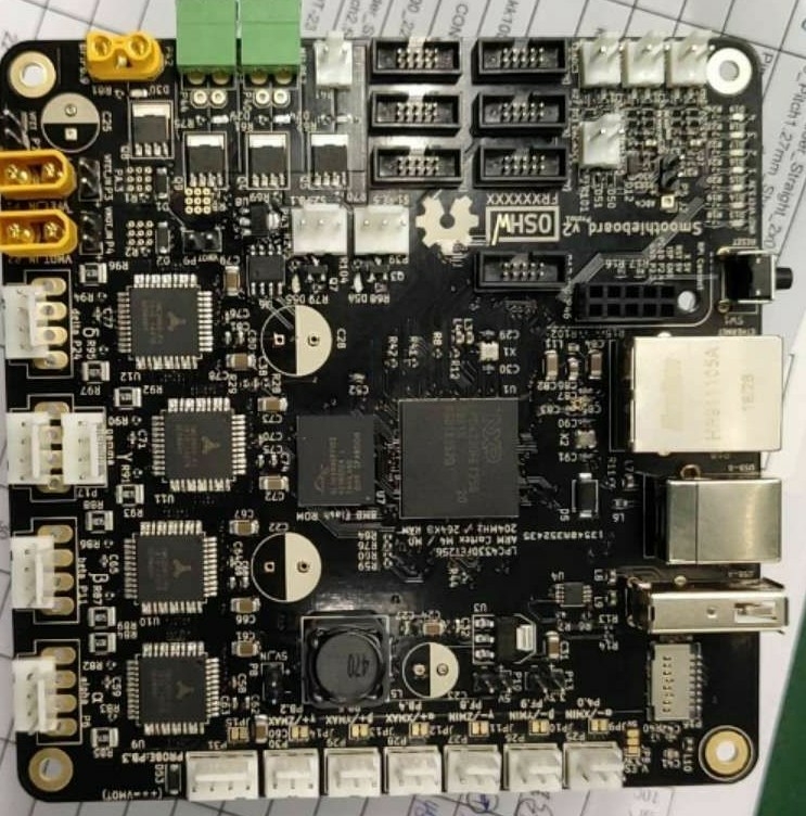

Looking Good , can’t wait to try one :slight_smile:
Just a question, i don’t see pin to connect external drivers, it’s possible or no ?
See the 6 connectors at the top ? Those are gadgeteer ports, they’ll let you add not only extenal drivers, but a crazy ton of other stuffs. https://docs.google.com/document/d/144EbmhN6z-J2V_Zw7GfJpZrfD-B0dC3cuea9oWPgxNM/edit#

After skimming again over the extension boards document, am I wrong to think we’ll be able to use it with both servos and axis encoders?
LOL @ the Edison use case opening quote.
Are the XT60 connectors for power?
@Jeremie_Tarot Using extension boards sure.
@Thomas_T_Sorensen Yep !
@Arthur_Wolf great! Does firmware already supports feedback from encoders, both linear and rotary?
What is expected maximum voltage on motor input?
@Jeremie_Tarot That’s up to the drivers, not much to do with the firmware.
@Marko_Novak 24v
@Arthur_Wolf I’m talking about double feedback loop: motor rotary encoder to driver for direction, and linear encoders on axes to controler for position
@Jeremie_Tarot That’s still up to the drivers, I don’t know any that will do that but they do exist, this is just a very odd/rare setup.
@Arthur_Wolf Granite Devices drivers handle dual loop, and LinuxCNC supports encoders feedback. Allows to more easily higher accuracy on lower end structure and components
@Arthur_Wolf yes it’s usually done on drivers, but I think it was thought more in line of industrial solution on the cheap :wink:
Linear encoder for actual position and rotary for live… Linear is saved on power off, fw comparator for position (halt/force logic)…

@Antonio_Hernandez Boards ready at the factor, should ship to contributors in the coming days. Then still a few weeks before we start KS.
This is V2 or V2 mini ? i don’t remember the difference, and for the V2 pro, the project continue ? i don’t listen news about V2 pro
