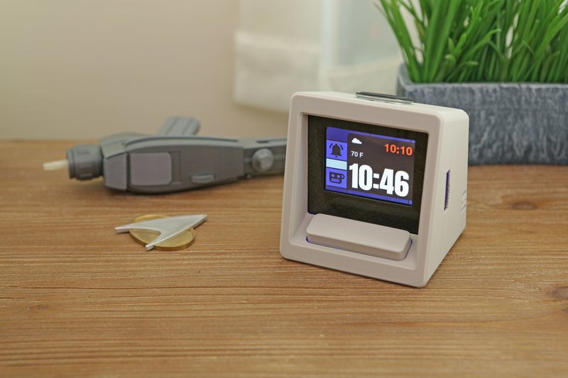

For instance, this project is pretty close to what you are looking for.
A wifi enabled clock with speaker. You might be able to use it as a jumping off point to make your own.
But you will notice its considered an intermediate project.
