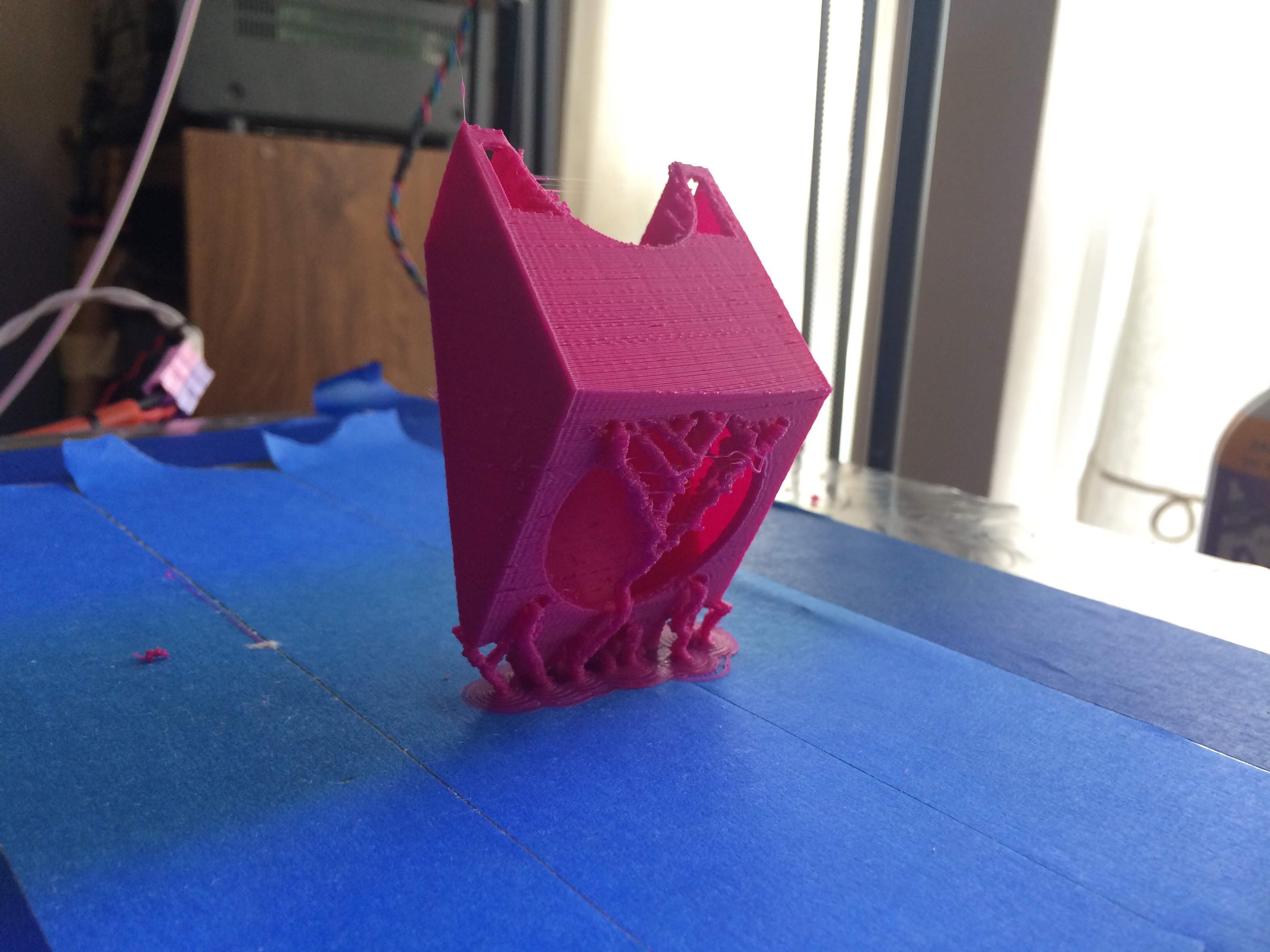

it’s a second print in that weird position I saw today… you did it on purpose? what’s the advantage of that?
I just did a big dorky/embracing LOL in line at the grocery store… Awkward.
@Jarek_Szczepanski , it can help you reduce the angle of overhangs and also make the structure stronger. Some people relate it to the “angle of repose”.
@Jarek_Szczepanski it was the orientation meshmixer chose to reduce the amount of support needed to print an effectively hollow structure. Other, more conventional attempts were less than successful.
Meshmixer gets creative, but I’ve had good results. Also, if you’ve had curling off the tape, or pulling the tape up, this reduces the contact area as well.
