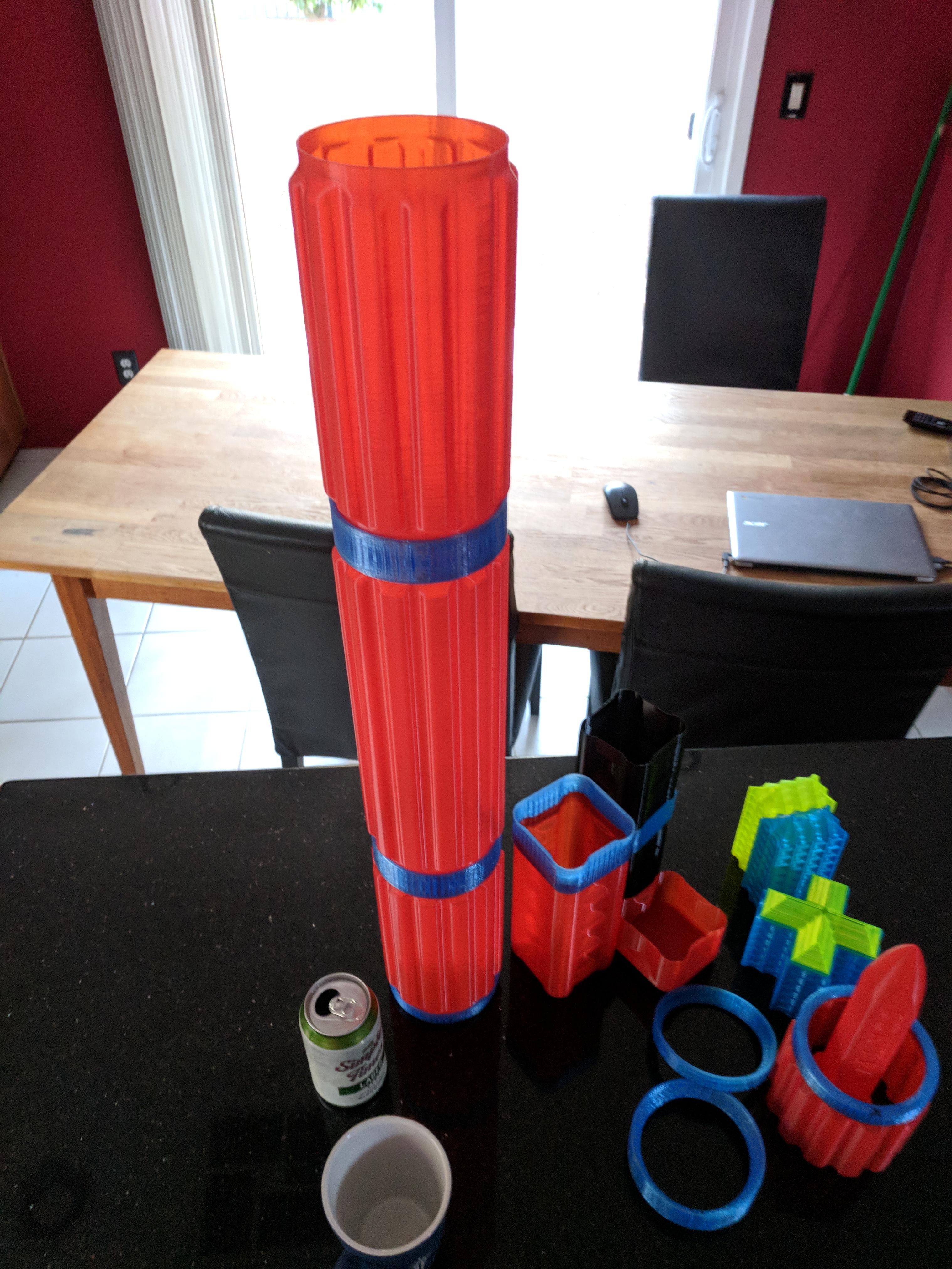

The red columns are printed with 0.5mm layers and 0.8mm walls (using a 0.8mm nozzle). As simple cylinders, the thin walls would be prone to crumpling. Was not sure if the 300mm column (center) would be sufficiently rigid. (It is.)
The blue bands are friction-fit to the join the columns. Seems to work.

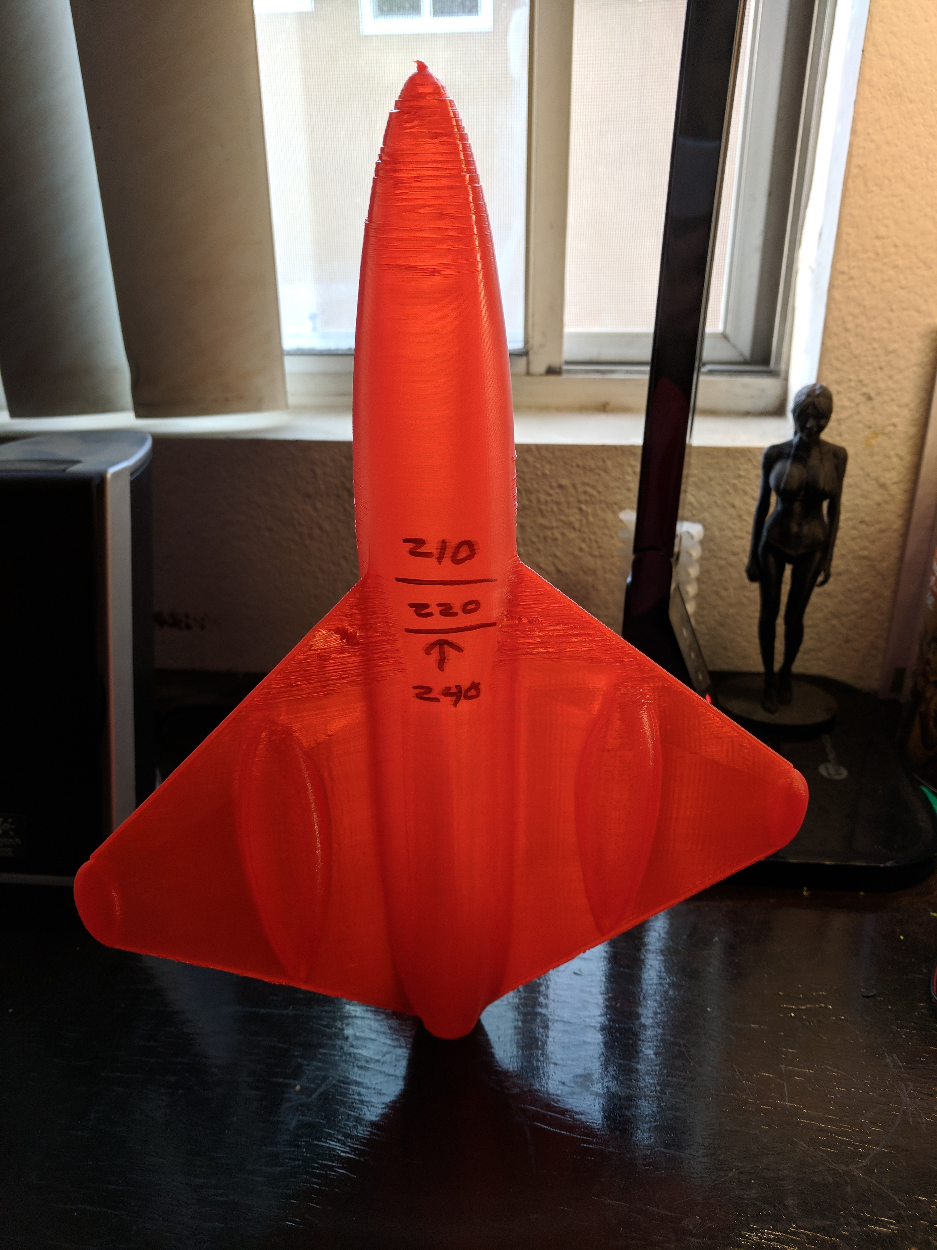

Without part cooling (left) the surface is both more shiny and slightly irregular. Not quite as nice a result, but usable.

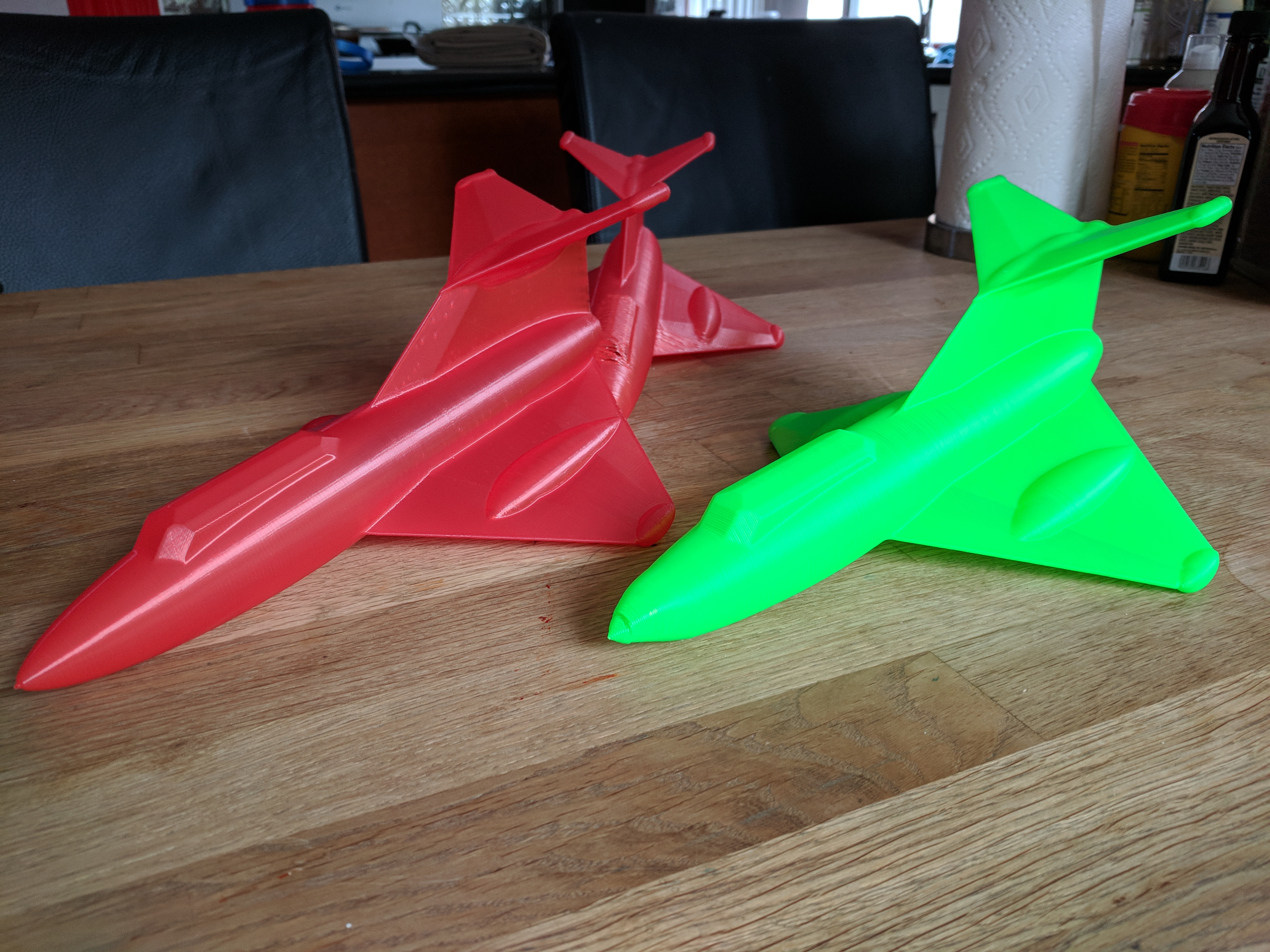

Red is 0.2mm layer height and 0.8mm width printed at 100mm/s with a 0.8mm nozzle. Nice finish but some artifacts.
Suggested as @Ryan_Carlyle noted the volume/rate of plastic is about the same for the different products of layer height and rate of movement.
Green is 0.6mm(?) x 1.2mm(?) and a different source (red is Maker Geeks and green is 3D Solutech), so the filament might be a cause (though they seem similar in printing). Had some prints at 0.6mm x 0.8mm and 30mm/s, but they left the state with my grandson.
