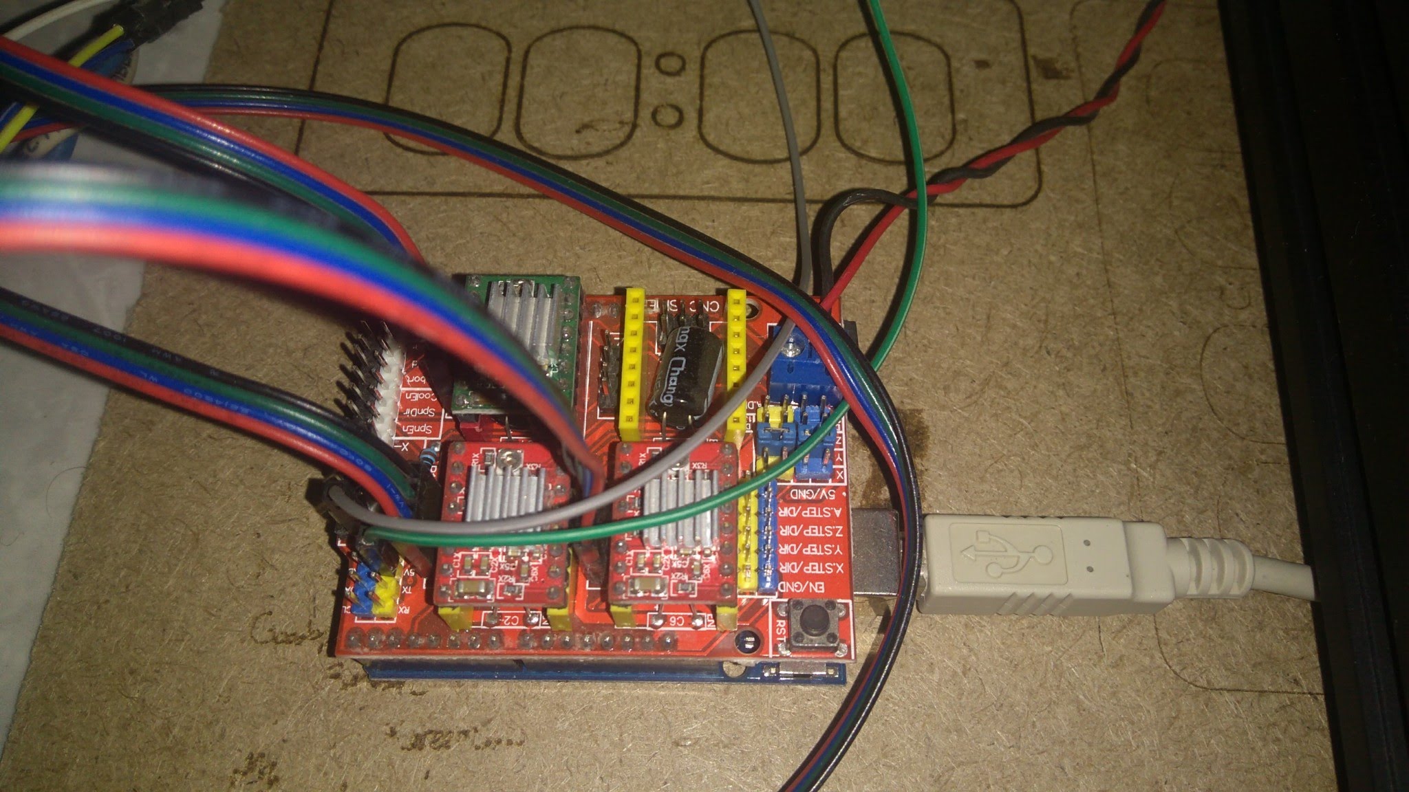

Witch board you have? How many cables came from the laser to the board? Any picture of your hardware?
@Joan_Sunyol
Cnc Sheild Board and One cable from Z+ and laser take 12V and GND
The Laser … I already Connected it With Transistor Because the laser not work with Z+ direct or spindle … so i Connect transistors
one from 5V from cnc sheild
one Z+ to get spindle
one To PMW in laser
so transistor take spindle from Z+ and pass 5V to laser
I’m sorry, I don’t know how to connect with cnc shield. I ha an elekmaker hardware.
Are you sure you are getting different power levels with this setup?
