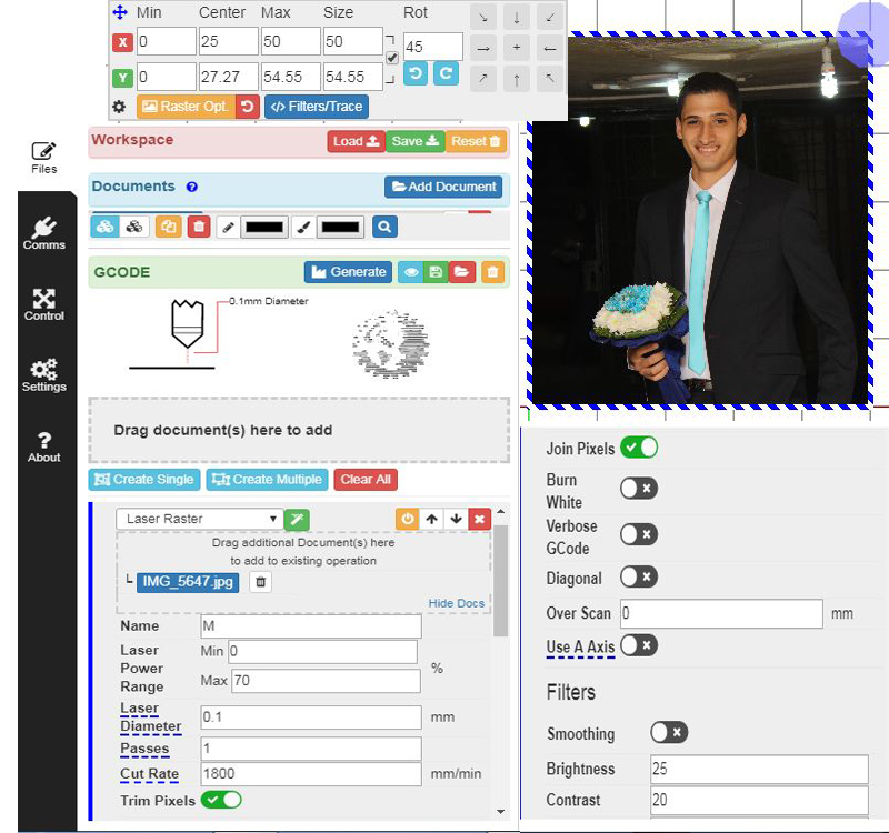

Hi, i have an elekmaker a5 laser 2.5W.
Can you post the original file you are trying to engrave, and the configuration on laserweb?

Hello This Is My Try Right Now and THis is Original Photo And Configuration in LW

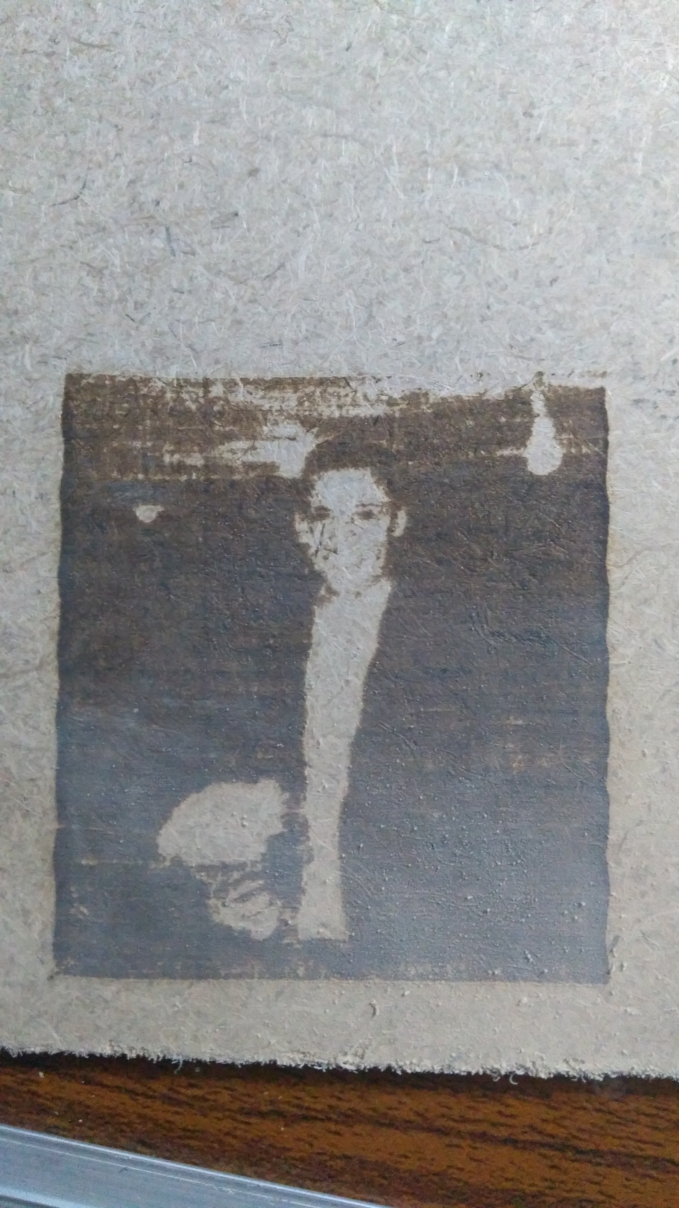

And this is the result
very bad trying @Joan_Sunyol
And the result of this settings?
Usually in my setup, I have to set the range from 15-20% white to 100% black.
I prefer to use a photo editor to set it b/w and save before using in LW

Yes, not the bests results.
