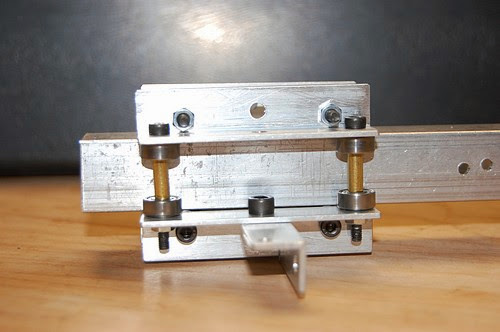

Good Evening. Please see v.2 pictures. 3x10x4 plain bearings. Brass tube spacers must be cut square and accurate length ! 8 more bearings and four tubes. Total 75.1 gms. I like the feel of this one. Your design . Thanks
