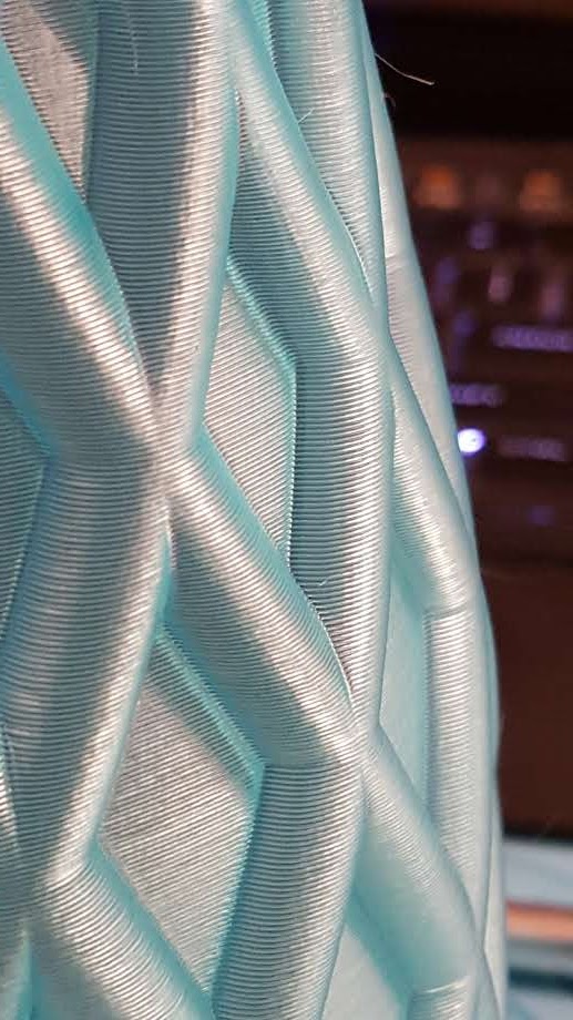

Good layers. Printer dialed in.
Good layers. Printer dialed in. This is .3mm layer vase mode for optical effect as it’s a lampshade. The base is .2mm though. It’s 2 models stacked and printed one on top of the other. One solid body for the attachment ring base and one surface body for the hood. Using 2 different profiles, the vase mode (.3mm single wall) print just starts as soon as the solid body ends (2 perimeter walls, 15% infill, 4 bottom and 5 top layers at .2mm).
What speed and material ? Good job :slight_smile:
@julien_dubessy Taulman T-Glase Aqua, speed 40mm/s on the base and 30mm/s on the vase mode section, thanks :slight_smile:
