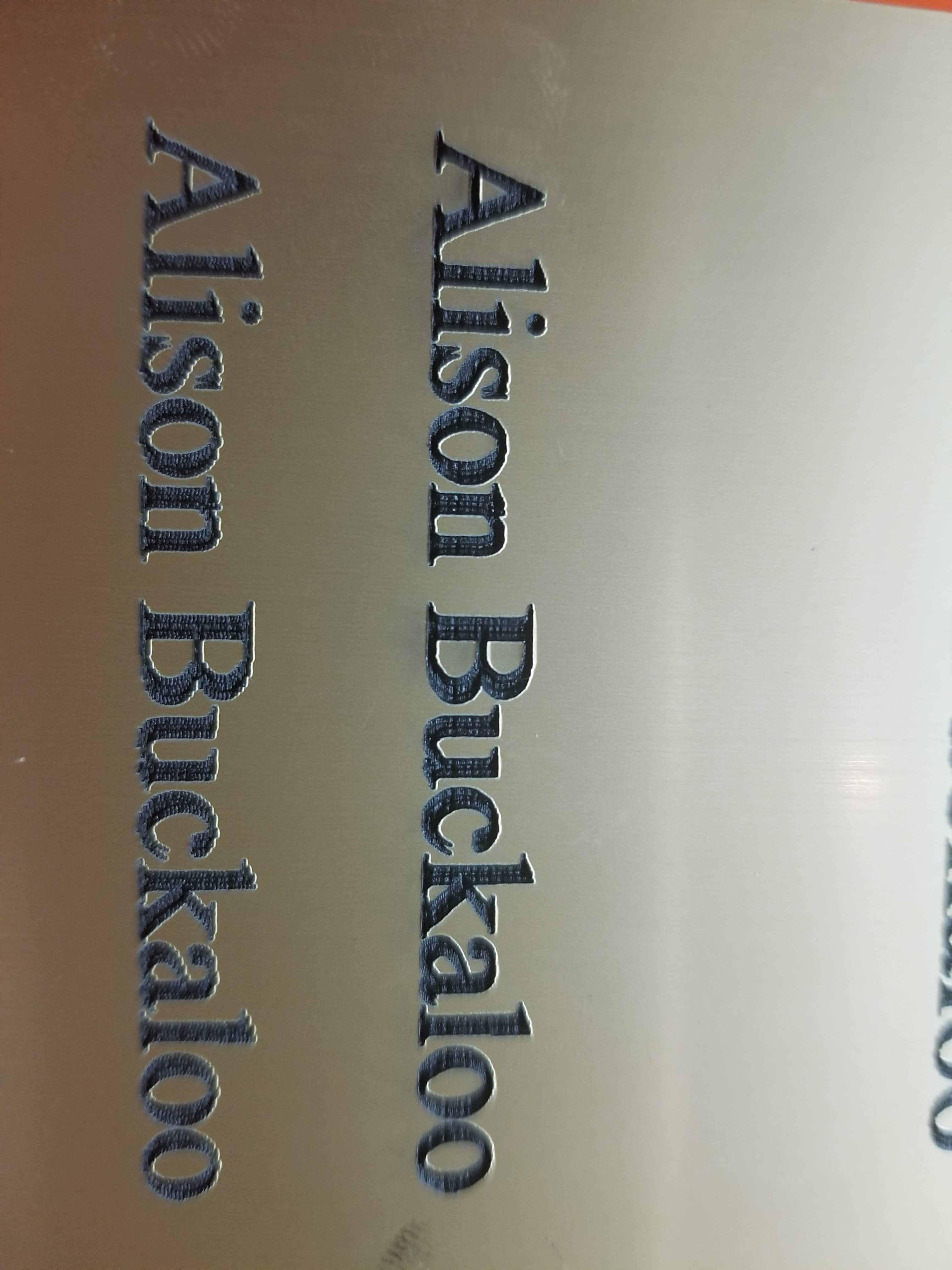

Good morning,
I have a new k50 and feel like I got it aligned well but my engraving has a bit of ghosting to it. If u look at the S and the C in the name u can see what I’m talking about.
Is there any other reason this could happen? Maybe a setting somewhere in the software for example? Or would misalignment be the only reason?
I’m using the lightburn software with stock controller

Looks like its engraving twice on top of each other just offset 1 mm to the right
Are you using scan and cut? Could it be possible that you get a belt skip? How fast are you engraving? Is the material jostling a little?
Thanks for the troubleshoot …I’m only using scan…and it happens regardless of speed, but the slower the speed the less it shows, but it still shows up…I have the material taped down. Of it’s not the alignment my next guess would be the belt but I’ve tightened the tension screw as well…no help
