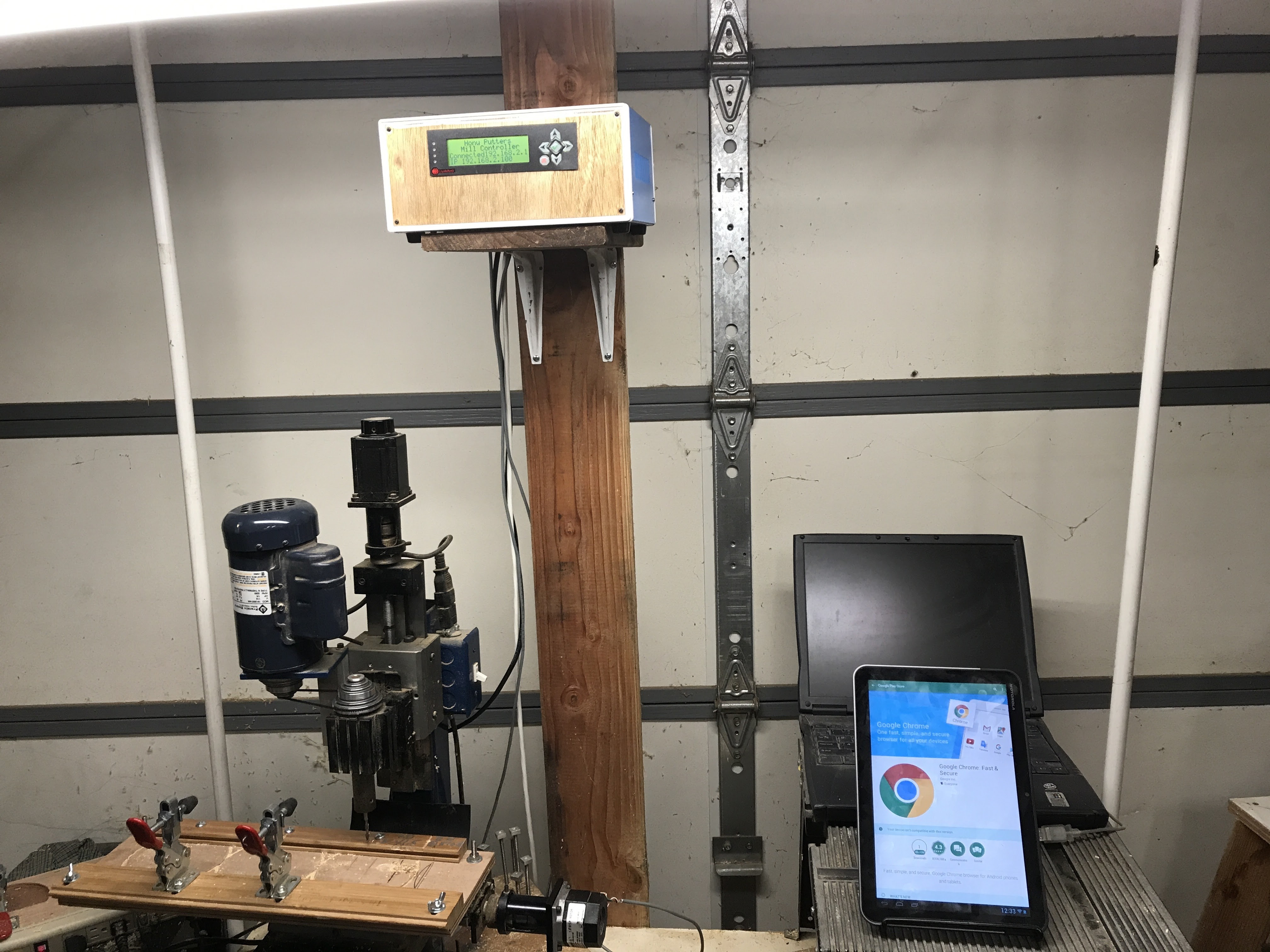

Good new / bad news. The good news is that my new controller for my Taig Mill, based on Arduino Due/gShield running g2core and Raspberry Pi Zero W running spjs, drives the mill 2x faster than the old Mach3 parallel port controller, using the same steppers.
The bad news is that trying to run it from a tablet or a phone with chilipeppr is an exercise in frustration. The full-up tinyg workspace is much too busy for a small screen, and the tinygtablet workspace, while a little better, is still virtually unusable. I experienced the following problems and more:
