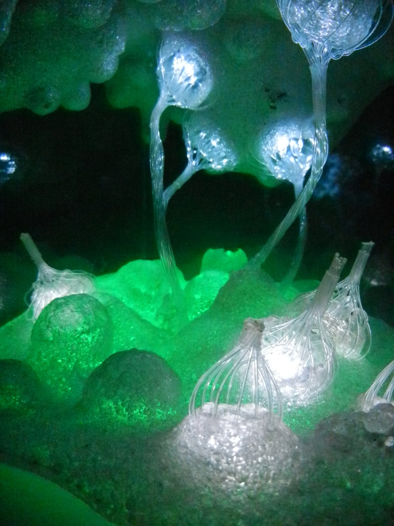

Here an example of the use. :wink:
green again - but I made blue ones too :wink:
wouldn´t it be nice with soft changing different green´s?

For a better color resolution you should work with the RGB color model, not with HSV. Show us your code (upload @Gist) and we can help you improving the effect. P.S. I see green and blue in you photo. In case it’s easier for you to explain the problem in german - do so because I don’t get the specific question yet.
