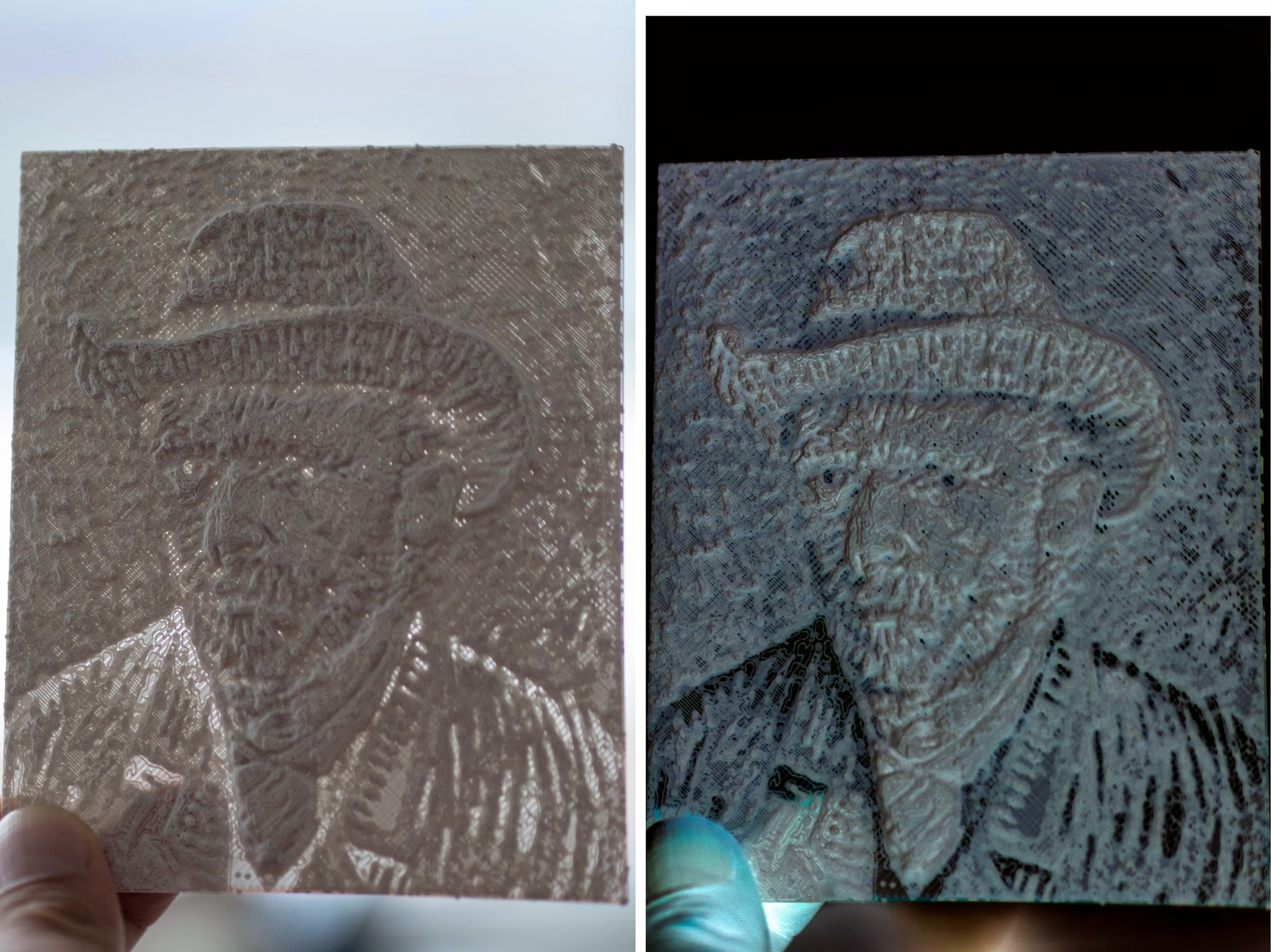

Google image search "Van Gogh">drag & drop jpg into Cura>medium setting>print,...;)
Google image search “Van Gogh”>drag & drop jpg into Cura>medium setting>print,…:wink:

I tried to do a Lithophane of “a starry night” but it didnt turn out as well (even though all my other Lithophanes photos did)

@Hugobiwan_Zolnir basically the tuto I described in the description above. In case you missed it: Google image search “Van Gogh”>drag & drop jpg into Cura>medium setting>print.

@james_wolf It might be that “a starry night” contains a lot black/dark so there wouldn’t be too much of a “height contrast”. I’ll give it a try to see what results Cura gives
Invert the image before you print it. That way the lithograph will light up in the light areas and not the dark areas of the image.
