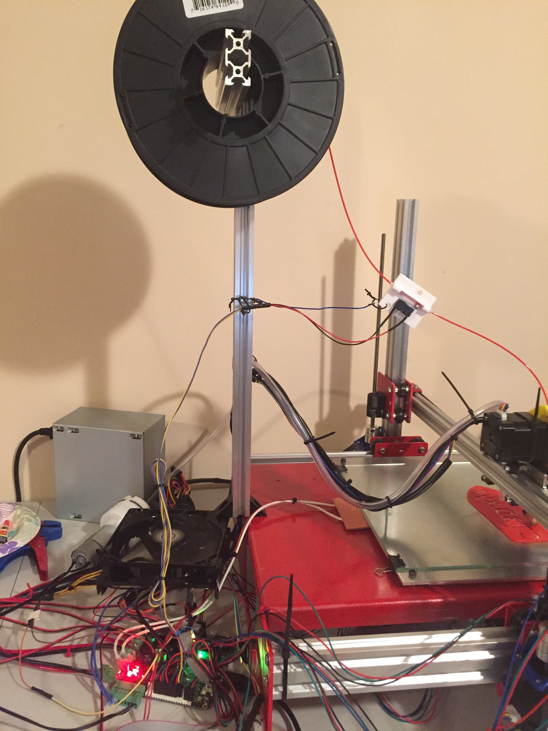

I have a plain roller switch with a ptfe tube and printed part doing something similar, Alex. As Arthur said its in the switch docs, well described, and you can have an extra endstops as the resume button, but I have had some quirky behavior with that one, and I prefer to use the “resume” button that will show up at supported hosts like Pronterface and Octoprint.
@raykholo ​ thanks for the picture. I will probably try it both ways.
