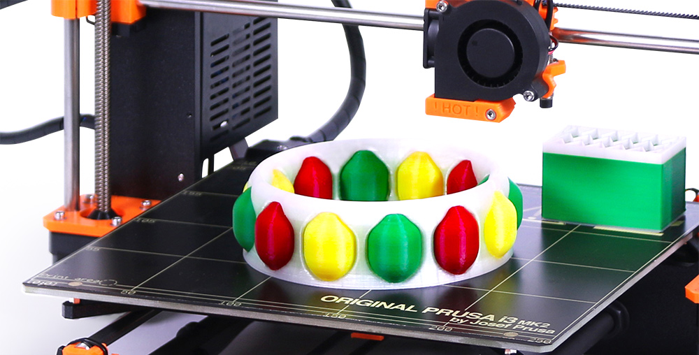

While this method of colour change is great you can find that on retractions hot it causes stringing that then jams other colours into the nozzle another solution that I worked on with RepRapPro was to do the retraction at 70-80 degree c with removes the fillament cleanly meaning you don’t need the purge tower
I’ve seen that before, how is this different and “ingenious”?
