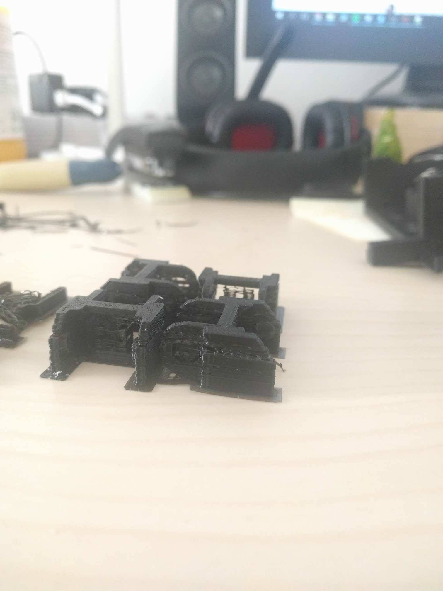

I have the same problem and I canň solve it. I tried better cooling, other temperatures and nothing helped. I have anet a8

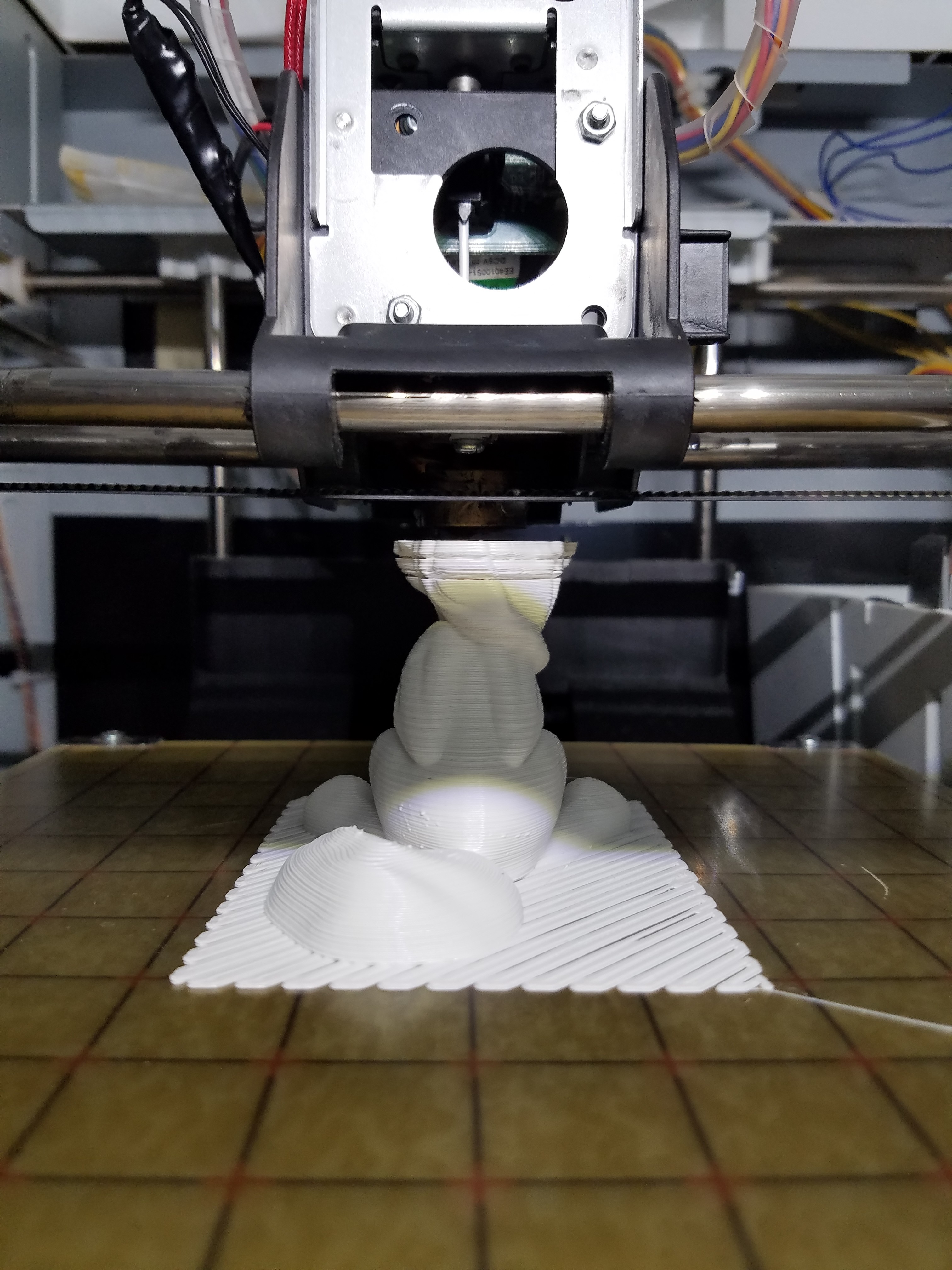

It acts like the z stepper takes a skip? I oiled the lead screw and bearings, and adjusted my bed height a little. It moved the skip area up the print about an inch?
Looks to me like an extrusion issue, not a Z motion issue. The outer contours of the print look continuous but with gaps where there’s missing material and then tried to print onto a missing layer.
White filament is often worse-behaved than other colors, by the way. And heat creep can happen around a consistent point due to changes in extrusion flow rate and retraction requirements. (It’s most common where the print speed slows down, but other stuff can trigger it too.)
@Ryan_Carlyle no you can see the z skip, then it prints in the air for a few?
Here’s what I see in the photo. Maybe you can see better/different in person.
Z axis issues like binding will cause under-travel, not skipping/over-travel.
It’s rare for 3d printers to travel FARTHER than they’re supposed to in Z… although it is possible. Specifically, if your printer turns off the Z stepper between Z moves, and then the bed drops under its own weight, you can get excess Z travel. But that happens where friction is low. And I don’t know if your printer turns off the Z stepper. Most printers never, ever disable steppers mid-print.
Your picture doesn’t show the z-axis couplers. This can happen with spring-type couplers if you have any binding. The couplers are compressed until the z-axis reaches a point that is not as bound up, and the spring pressure is released giving you up to a millimeter of z-axis jump.
@Ryan_Carlyle thank you, I’m doing some more testing tonight, I got this printer used, with some questionable mods done to it, it’s a xyz, it’s had bearing support done and hot end fuse added, I had to completely rebuild the hot end and undo some mods, then I added a Bowden tube set up. The z coupler is a piece of shrink tube? I think that might be a good place to start?
@James_Whittington the coupler is a heavy piece of shrink tube? I got it used, still some work to do?
