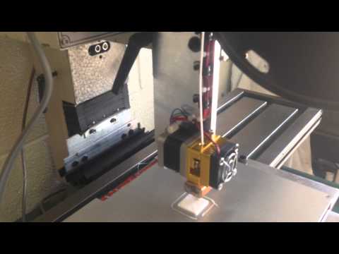

But how to control the temperature of hotend and bed in software?
I haven’t found any viable output channels in MACH3 that one could use here and no good hardware to do this and that runs from a 45-48V stepper power supply.
