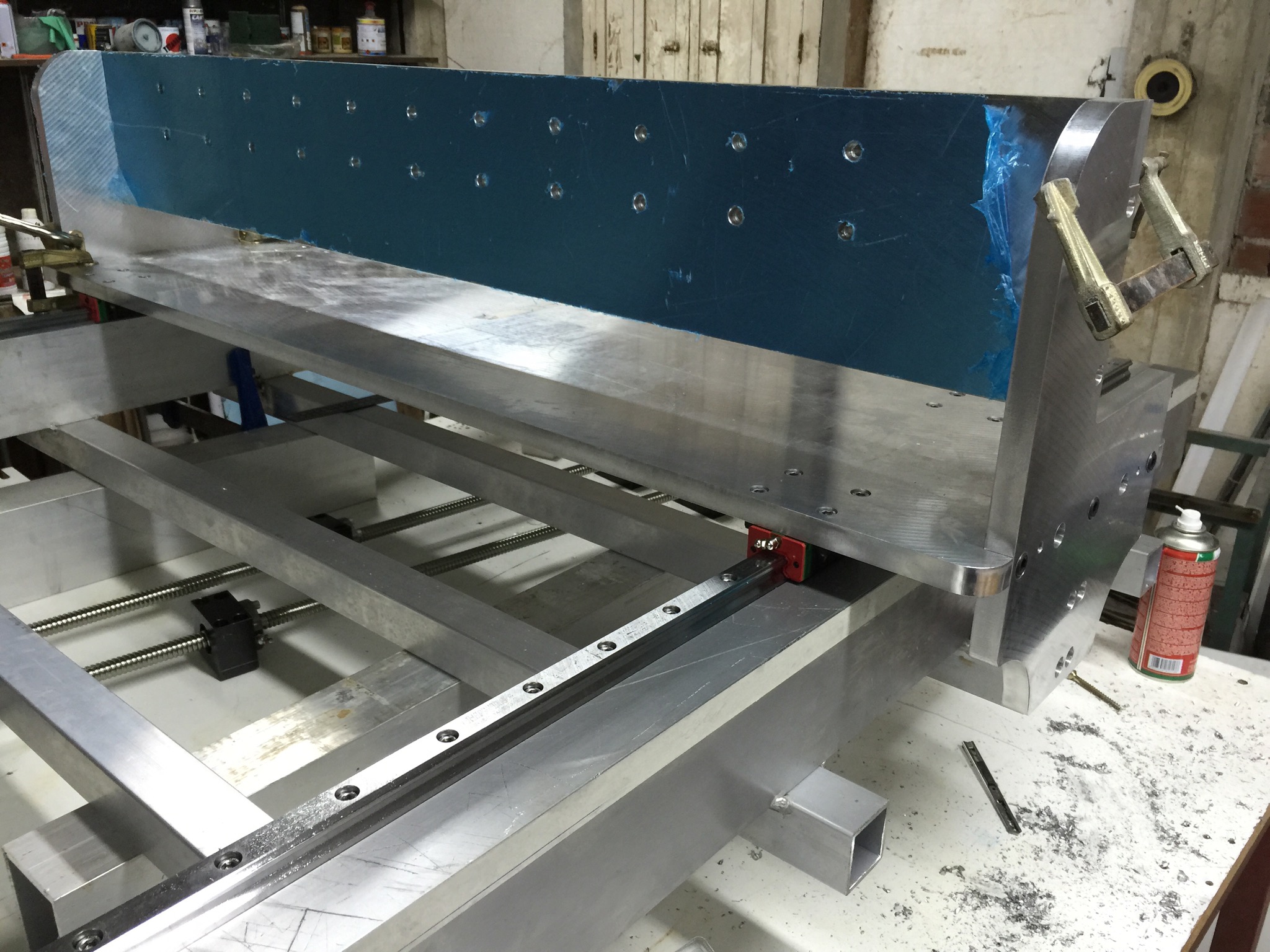

Very nice indeed Eugenio. I for one can truly appreciate the work that you have put into this. Is this 2 meters by 1 meter?The vertical axis looks impressive also.

@J.P_Saini Spend the money wisely once and the quality will last a lifetime. Buying a comparable machine would easily cost many times more. The plus side is that Eugenie will gain valuable experience and knowledge. Mucho bueno mi amigo Eugenie
Dear friend thanks for the comments!
The machine its about 1500x1000 work area and measure total its 1700x1400 i spend about 400$ in aluminium, 1000$ in X actuator
And Z actuator 450$ and guides of Y axis and block bearing about 350$ and motors is need and reducers and … Its a hole for my pocket
Again thanks for comments!

@Marco_Zanti Ciao,Si tratta di una macchina per la registrazione e taglio quello che viene chiamato in inglese un 'cnc router "

Correct me if i am wrong but you limit your z Travel with the plate That linear guides fixed on.
@omer_can_Inci yes, the upper limit its the guide lines and botton its about 120 milimeters, the plate of Y axis its 350milimeters then i have more rigid i put more photos soon… in afew days with ballscrew and bridge mount…
