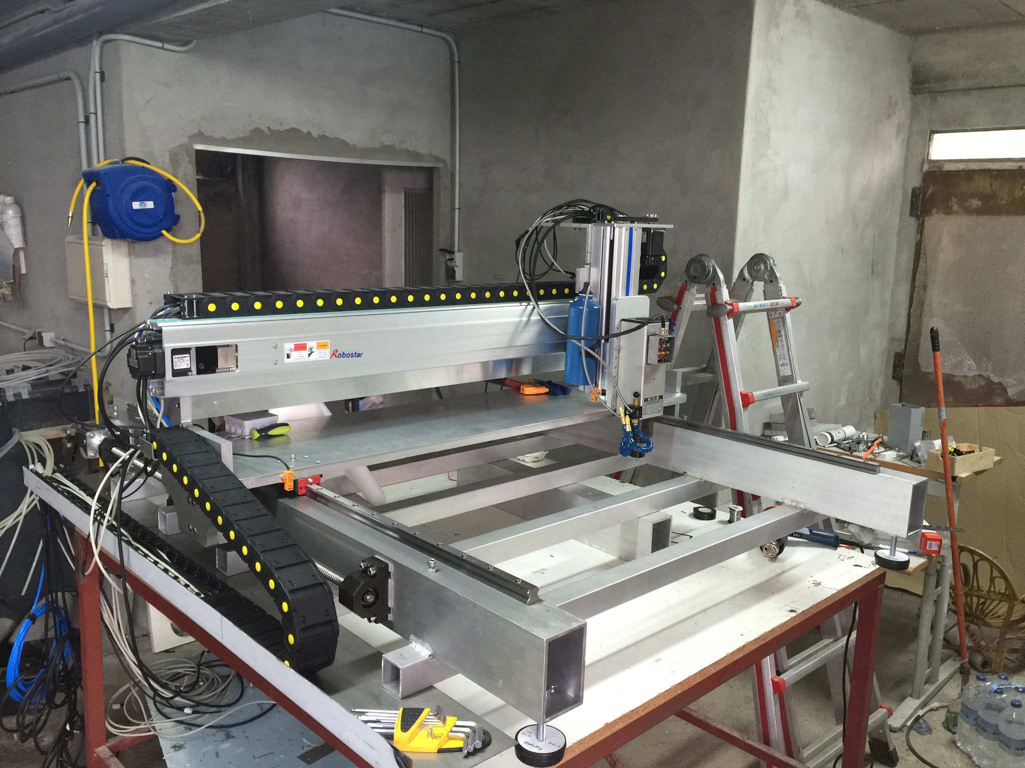

In progress…
Really beautiful build !
Veo que no escatimas en electrónica
@Anthony_Webb thanks man. :wink:
@rafael_lozano un buen hardware debe tener el mejor software querido amigo :wink:
Ya veo que vas a utilizar el mach3, por comunicación ethernet
That looks like it will be a beast! Nice
@Jarrid_Kerns thanks and very faaaaaast! I think speed about 15000 at 20000 milimeter /minute i will put videos soon,
I have been slowly buying parts to make one. Issue is, my design in my head keeps changing
@Jarrid_Kerns design change my machine about 7 times, you should be fun with it :wink:
@Eugenio_Villaverde ​ really looking good! I’m looking for a replacement for my kress would you recommend the one you have? How much does it go for?
@Sam_De_La_Haye Hey Sam many thanks, i have often spindles in past… kress too,
i used kress but its too noised then i buy a chinese water 2.2kw and used for a 2 years (hard work and cheap spindle) then i found elte for this machine and have a giordano colombo for old build machine, for quality/price the chinese 2.2kw 18000rpm its a very good option but i not forced i put this spindle about 80 or 90 percent of capability about 17000 rpm max, this spindle with vfd its about 350$ in ebay other spindles like a elte cost about 800$ plus vfd 300$, i hope this help you my friend :wink:
@Eugenio_Villaverde ​ thanks! Really helpful information! I’m going to have a look at the elite one, could be a good alternative to the suhner I’ve seen. I might seriously consider one of the Chinese ones, thanks again my friend! :wink:
