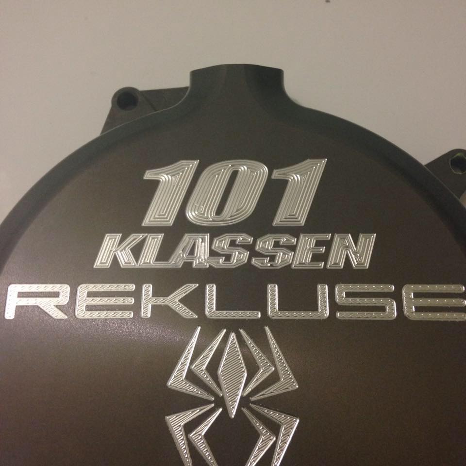

In the middle of a cool project for a local business and Motorcycle Race team. I’m engraving the riders names and numbers above the Rekluse brand name on a bunch of Clutch covers.
Last night had my first freak out as Mach3 froze and crashed my PC when I went to start a new piece. Had to un install and reinstall and reset the settings in Mach to get going again!!!
very nice ! I like the 45° pathpattern!
Very nice. what kind of machine did this, and what did you use to create the toolpath?

Nice work, can you tell us about what kind of tool you’ve used?
I am using a Taig mill with Mach3, and the code was generated with Cambam,
using a 3/32" ball mill for the pocketing, and a 1/16" ball for the profile of the lettering. DOC was 0.2mm My CAM software could not copy what rekluse used for the logo and the name, but I liked the visible toolpaths for this project, so used inside to out for the pocketing MOP
