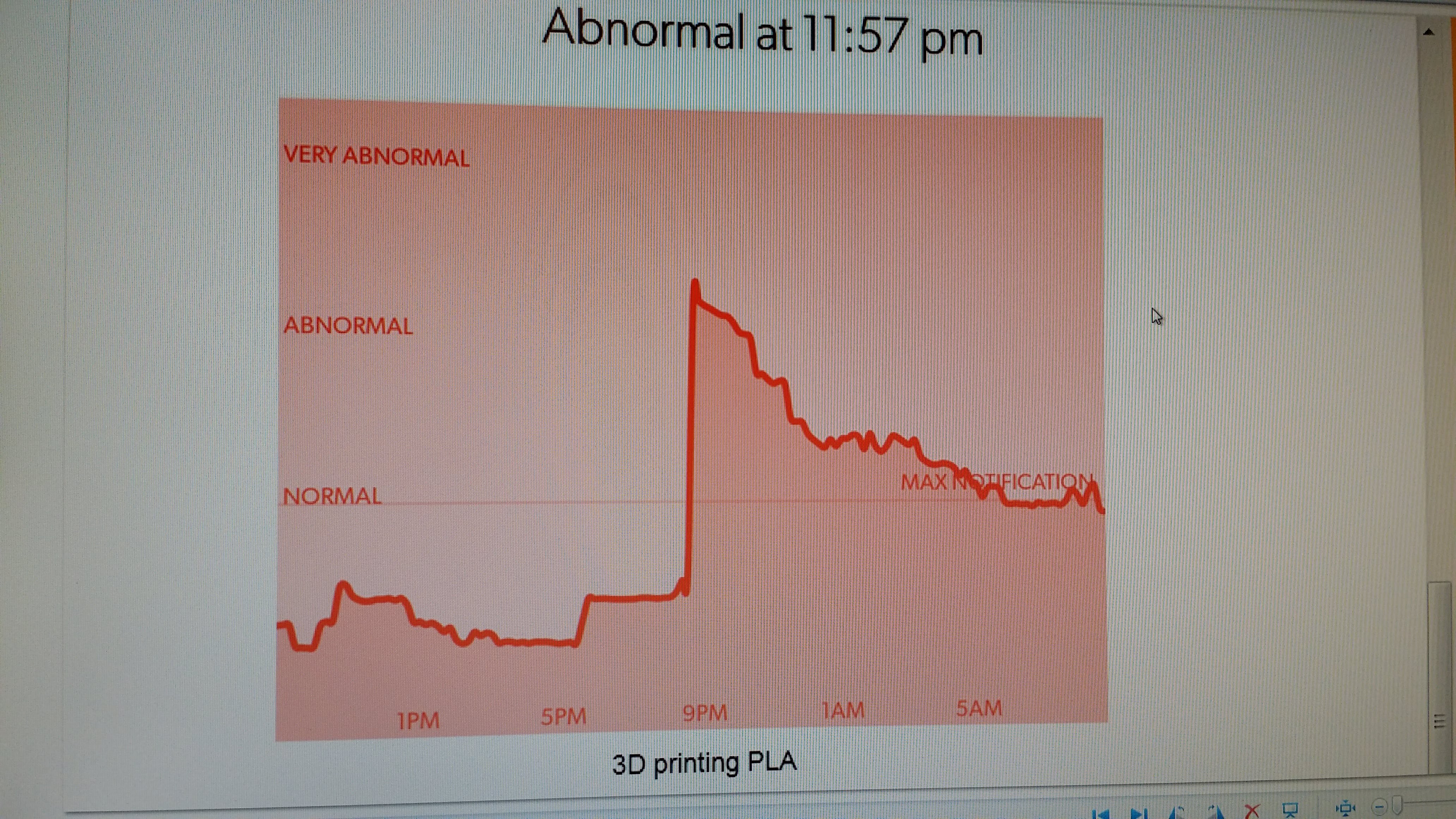

I tend to believe this article. I was quite puzzled several times when my “Canary” security camera and and “air quality” sensor would go off. After awhile, I realized it always occured about 20 minutes after starting a 3d print. At the time I was only using PLA. The graph would show a clear gradual rise in bad air quality within minutes of starting a print.

Here is the graph of my living room air when I started 3D printing as measured by my “Canary” air quality sensor. I have no idea how harmful it is but the sensor sure picked something up, but cooking never set it off.
