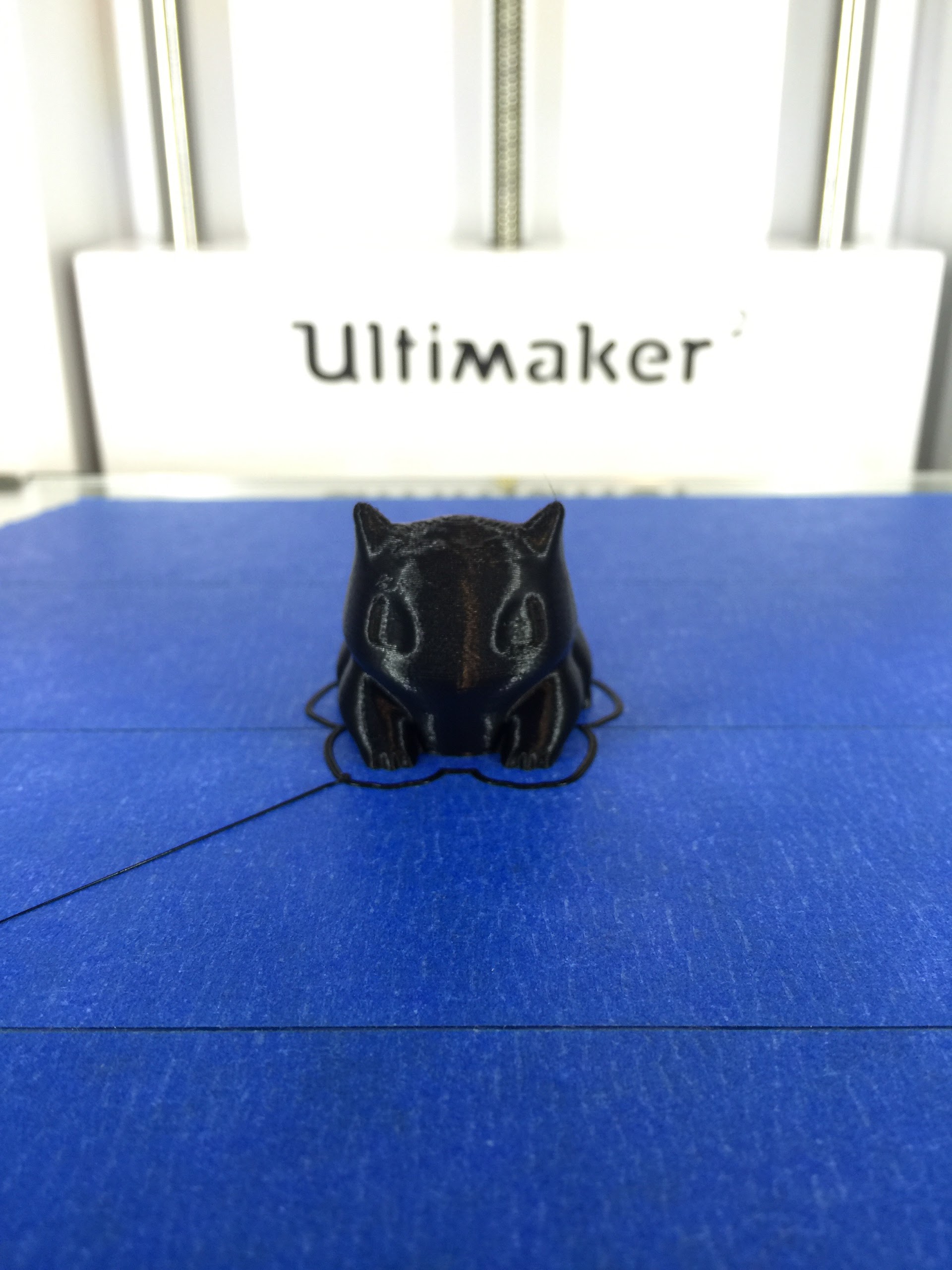

no need for the blue tape on an Ultimaker 2. set the build plate temp to 50c and use a little hair spray. Use the glue stick when you really need a strong hold.
@Christopher_Walker hey Chris! Thanks fro the suggestion, I notice the glue wasn’t cutting it, must of the prints I tried with the glue came off, since using the tape I’ve had 100% success on my prints… :slight_smile:
Could be that you didn’t level close enough.
@Christopher_Walker yeah, I thing I might readjusted the bed after the tape… I think I did… how often u wash ur glass plate with the hair spray?
maybe every 10 prints. It’s the glue that really builds up. Print a holder for a razor blade, you need it with the glue on glass.
@Christopher_Walker
naw… i don’t want to constantly clean the glass… I think I mught just use the tape, it’s real easy to replace. :slight_smile: Thanks for the Help!!
I think it is all a matter of the material. Tape fits PLA, glass fits ABS.
@Alex_Cam
Agree… :slight_smile:
