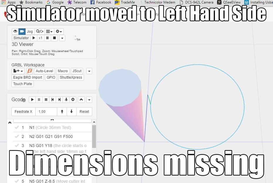

It looks the same on /grbl-new workspace, which is using all the same widgets, except the autolevel (the only one I modified). Possibly the 3dviewer widget has been modified by the grbl workspace owner which causes the issue.

When the 3D viewer toolbar is on the left side it means the 3D viewer crashed on load and the code that executes at the end of load, which moves the toolbar to the middle, didn’t run.
@John_Hornsby-Hunt Today I tried /grbl workspace on a
in my workshop - got the same result as on your screenshot. Then I cleared cookies and browser cache (I’m using Chrome), refreshed by F5 and the page is now being displayed correctly. I hope this helps.
Hi there Sebastian, thanks for your input. I’ve tried the refresh option etc. but with little effects. It seems to be the luck of the draw as to when the Chilipeppr page loads correctly. I just keep trying to load the page until I get one that works then I don’t close it when I’m finished using it – I just leave it running (sometime for hours or days) until I want to use it again. Someone put me onto using F12 to view the Java Console. It reports 4 errors and about 12 warnings. I have no idea what these are and wouldn’t have a clue where to start to try and fix them. All in all a great pity as Chilipeppr was a really good app.
Thanks for all your help guys……
This problem use to exist in the TinyG workspace and it was that different widgets were loading the Three.js library but some were referencing an old library and some referenced the new library. Each widget had to get looked at to make sure it was pointing to the correct URL. It finally got solved. I’m guessing this issue just arose in the Grbl workspace and it feels random as to whether you’re getting the new Three.js library or the old library depending on load order.
