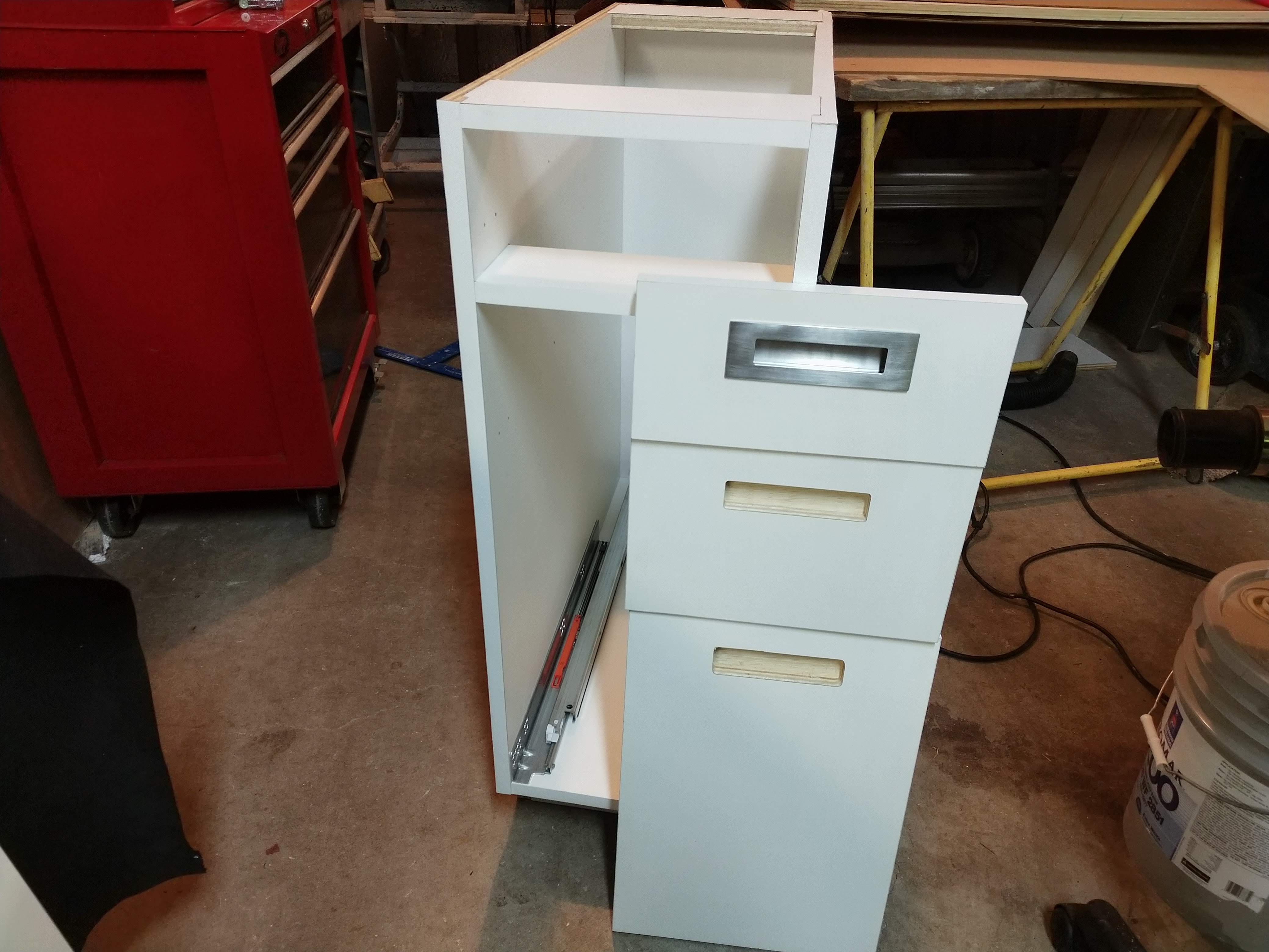

My first cabinets with the OX and Mozaik CNC Complete.
@Jonathan_Roeder Nice! Did you mill those metal handles on the Ox, too?
Thanks, and no sir, the pulls are an Amazon find.

Is it just the picture or is there a bit of warping on the right side panel? - did it swell when it was primed or are the tolerances tight? - Looks Awesome though!
No warp, just poorly stacked and yet to be installed.
