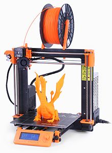

It is my thrid 3d printer. Made a hypercube and a cheep i3 knockoff. Now for the real deal.
Do not, I repeat do not tighten the x idler screw to seat the m3 nylock as instructed
it will rip the screw head through garunteed. The user comments form each step are worth reading before doing the step.

Having built two so far: there is one part in the build process where the nut and bolt you need are actually in the package for the next stage – so don’t panic when you get to that point (easiest to simply take them from the spares bag Prusa so thoughtfully provide).
Oh, and I suggest removing the protective plastic from the little screen before fitting it in its box, then sticking it back on again immediately you’ve done so (to protect it during the rest of the build) – otherwise it can be v. difficult to get it off later.
