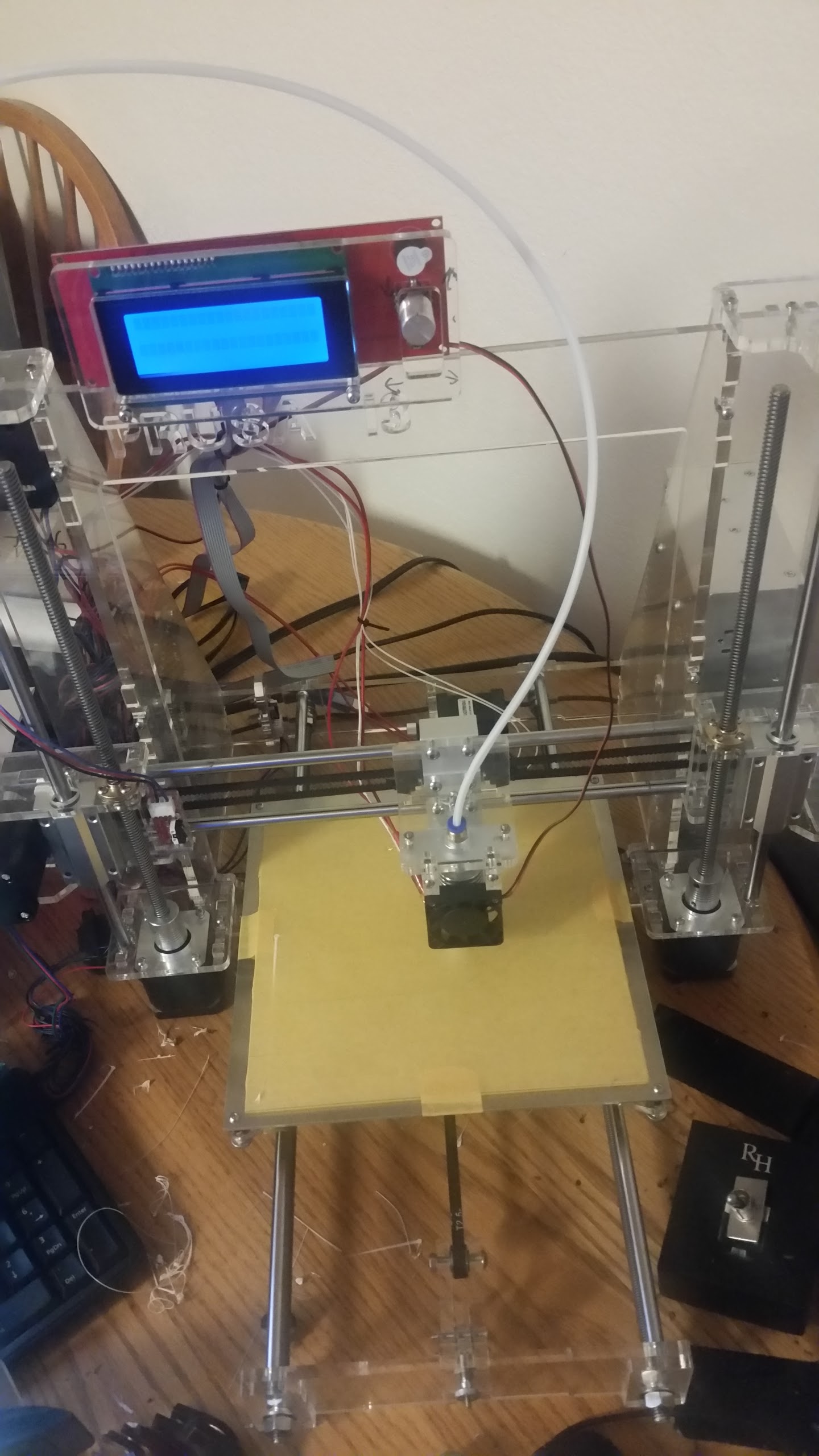

Are you still getting the issue with blobbing on one side? Or are you more worried about trying to fix the layer registration? And is that supposed to be a circle instead of a lemon-shape?
Yes it is so posed to be a circle that’s why I took a photo …duties she nice that print I calibrated mt steps and not it prints circles…but still, my hot end is cutting I to my print like my bed isn’t level …yet when I try and level it …I use a pice of paper to space the hot end away from the bed. But the hot end is so loos it just sits on too of the paper l, when I take out the paper, the hot end falls to the print bed and touches it. I’m not sire what to do.
So, the first thing you need to do is calibrate your steps_per_mm values in firmware: https://www.youtube.com/watch?v=Mbn1ckR86Z8
Watch all 3.
I have already done this …I just discovered that the pice that’s holds my hot end is broken. So I have no clue what to do. It’s not actually made by prusa …it’s a prusa knock off so Idk where to get replacment parts.
Hey. What of my fillamnet is not an even measurement all the way across the spool…qill that make a problem?
There are a lot of issues you’re dealing with at the moment. Out-of-round filament is probably the least of them.
Oh. Okay ?
