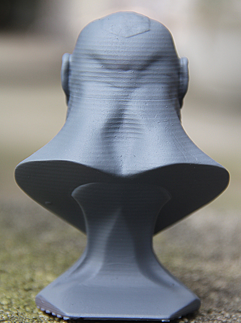

Nice and wavy!
Yeah, where is that banding coming from? It looks great, otherwise.
Great! Do you have the stl?
If you put a piece of the leadscrew next to the print you would see the corelation, I think.
I used to get that when my Z screws were constrained.
How big is that? That’s some crazy banding you got there.
@John_Ridley i’d think that wouldn’t be an issue on stl machines since you’re not actually squishing extruded material down.
Z wobble
