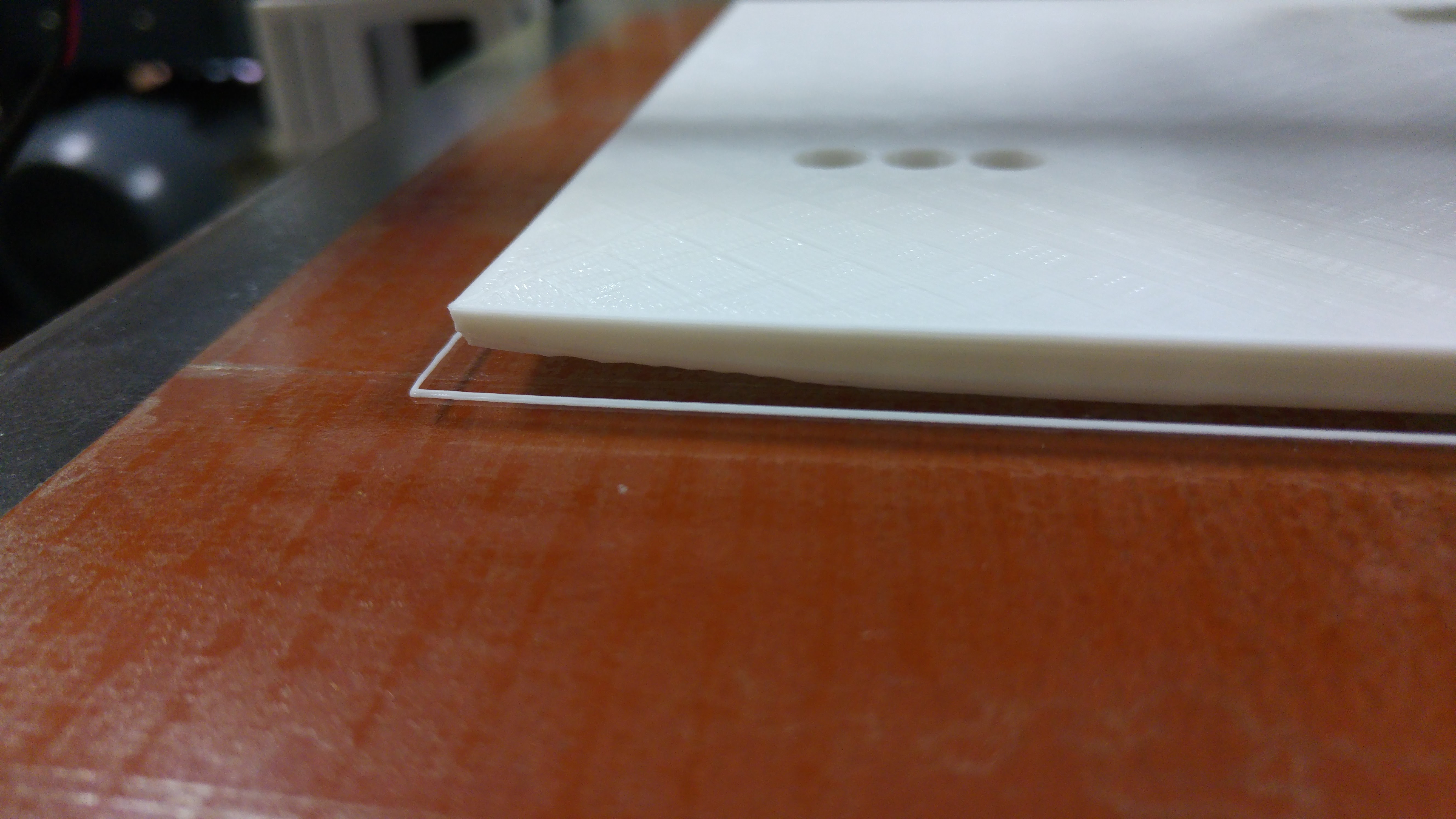

I was hoping I could get away with it. But I’m just going to can it and start over… Maybe do some smaller parts for now.
@Michael_Scholtz
Did you try some adhesive for this print?
The one before it was a 12 hour print that was similar and printed fine. This is the 1st print on this printer that I stopped due to quality. I stopped it in the end because it has to be perfect. It’s a 1:http://18.scale model of a 2 story building for an architecture students final project.

@Michael_Scholtz I had terrible warp issues with ABS; tried everything - adhesive (no good), ABS slurry (solution of ABS in acetone) (no good), 3M Blue Tape (OK, but not perfect) and finally tried a PEI bed. So far (about 10 prints later) it’s been perfect! It’s not cheap, and you need to make sure you get a good (3M) brand, but it seems to solve warping very well. You may need to boost your bed temp by 5C or so, but it’s a huge relief to be able to print large ABS prints without warp… I got mine here:

Can you print it in PETG?
That’s a pla print… Usually warping is not an issue at all. I’ve searched for pei but have yet to find a local stockist. I use a 45’ bed and hair spray. And part didn’t want to come off the bed while it was still warm.
Are you using grid infill? Try something which has less tension like a honeycomb.

If it is just a model, use the minimum fill density - 10% or so. Switching the infill pattern may also help.
In the end I turned the model 90’ on its side and printed it. One of the benefits of a sufficiently large print bed.
