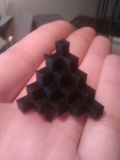

What did you change from the first try to this one?
Releveled the bed, increased idler tension, increased minimal layer time,
