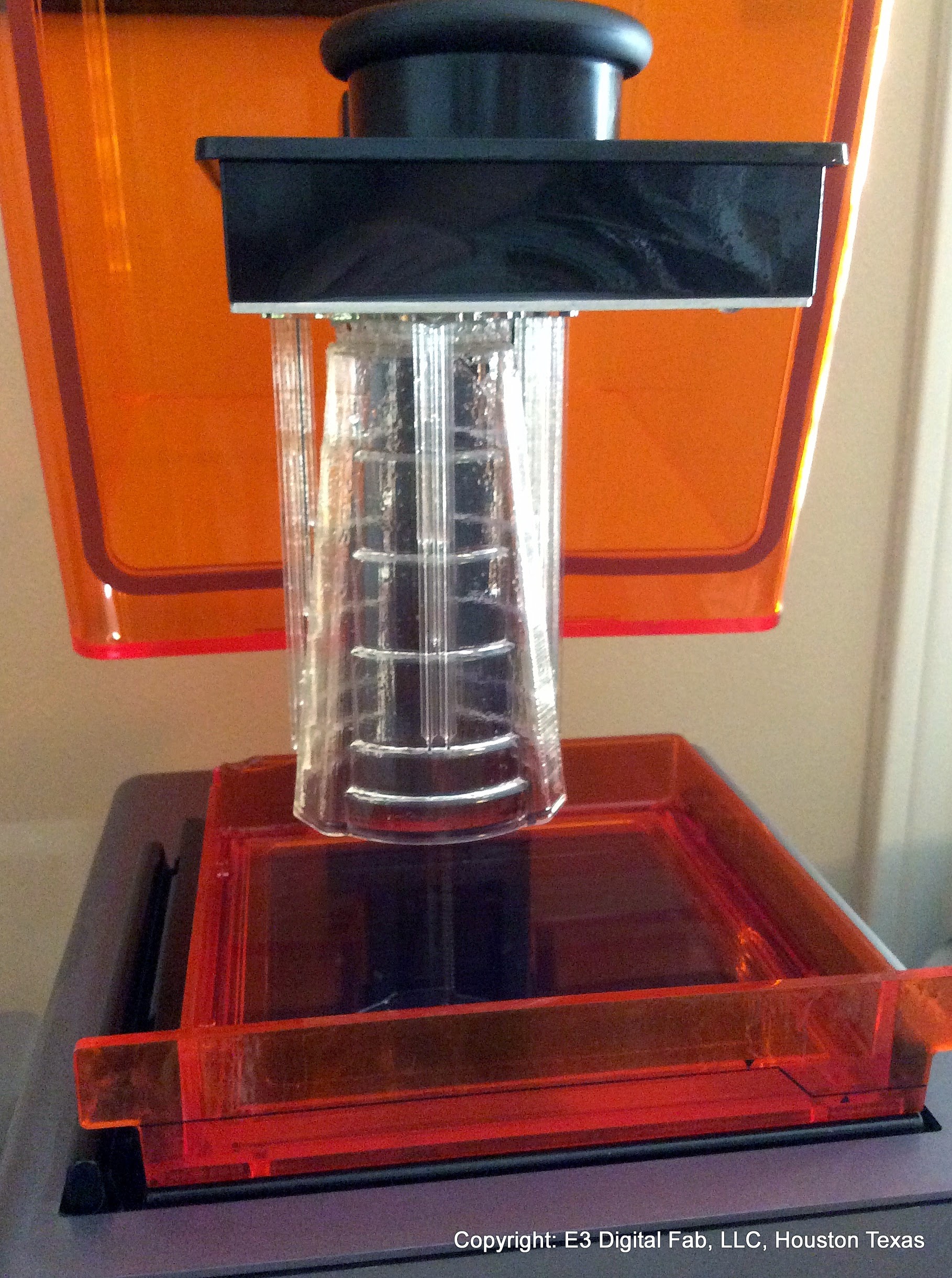

Tallest thing I have printed on Form 1+. This was 0.1mm layers. Software would have preferred to tilt it but it was too tall for that so had to print it flat so bottom suffered slightly. Serves its purpose of evaluating design, though.
Gosh I love resin printers. Why didn’t you print it at a higher resolution? Is it just cause you wanted it faster?
0.05mm probably would have been overkill for such a gentle slope. It’s not worth doubling the build time for that.
I forget the print time, it was overnight, about 12 hours or so.
No need to up the print time with higher resolution as this was for prototype testing of the shape. It would be injection molded if produced.
