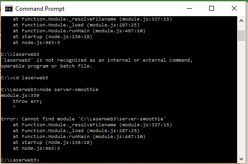

Any idea what I did wrong or additional steps needed to make it work? Installed on windows10 using git, can’t make it start…
You did npm install before running the server?
I thought it was just server.js now.

Now really going sound lost, what is npm and where do i get it?
Thanks, will give it another shot tonight
