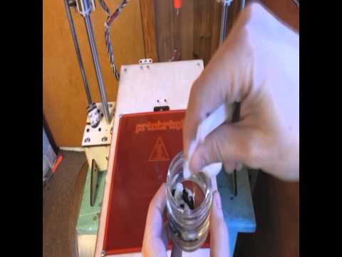

Interesting to see if ABS juice can be used though don’t think we can try that. So far, we have been using tape (different types too - http://funbiestudios.com/2013/03/alternatives-for-blue-painters-tape/) a lot. Though we have see some others in the community try PVA glue mixture and also double sided tape (which we also tried to good results in avoiding warp though cleanup was a pain)
