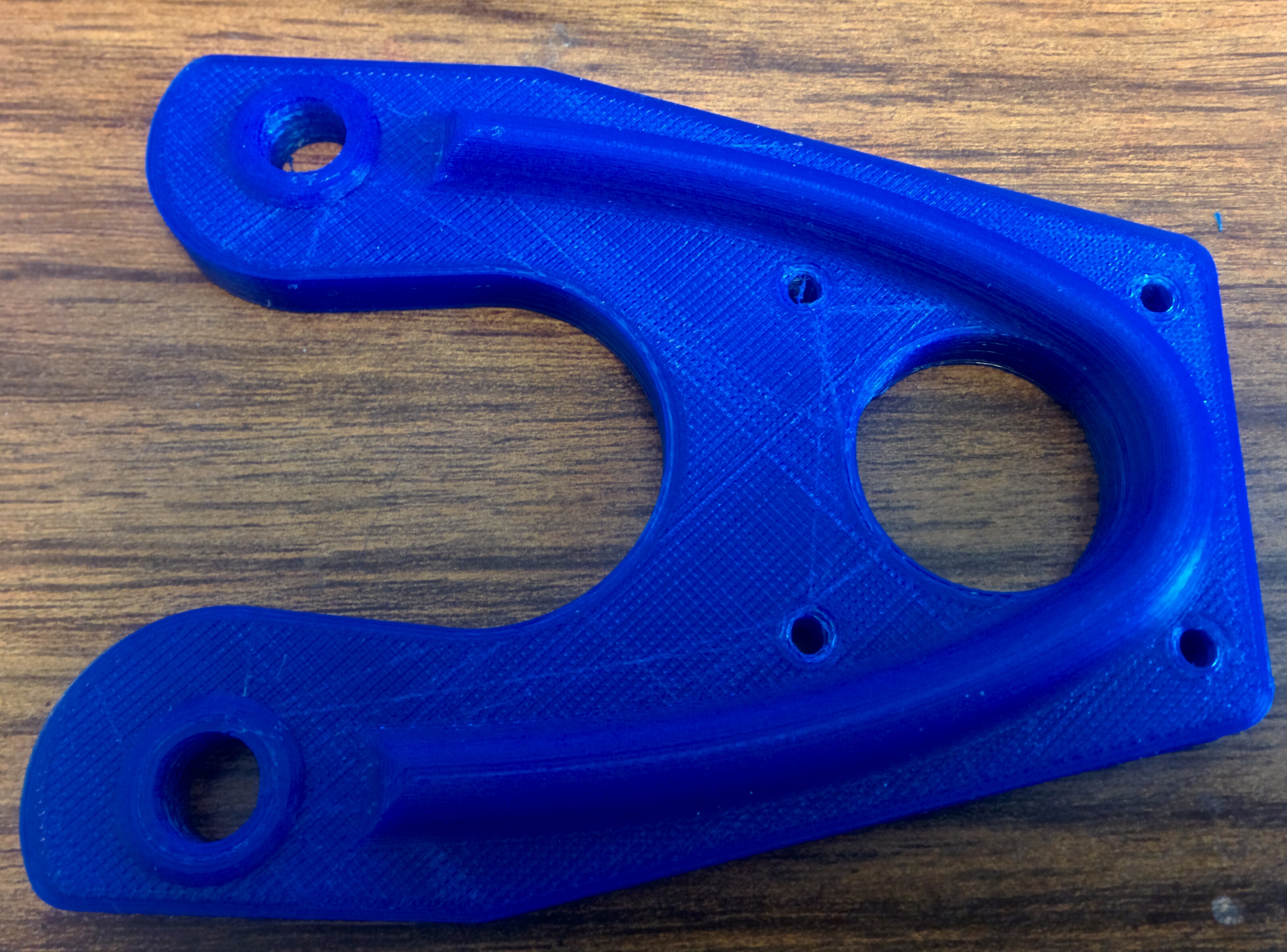

Feb 5 of #FFo3DP and #mostlyprintedcnc.
Busy reprinting allot of my parts. Do not print I’m Abs!

@Nathan_Walkner ​ I’ve printed this set in ABS as well, and the issues basically come down to some cracking, a few holes need to be drilled, and some sanding needs to be done.
Have a set coming on in @colorFabb_Filament 's NGEN, which is Rigid with a small bit of give for clamping, makes it a perfect plastic for it. Doesn’t really take on moisture either.
@Nathan_Walkner The shrinkage in ABS will cause a nightmare when puting everything together! +Ryan Zellars also recommends PLA over ABS…
