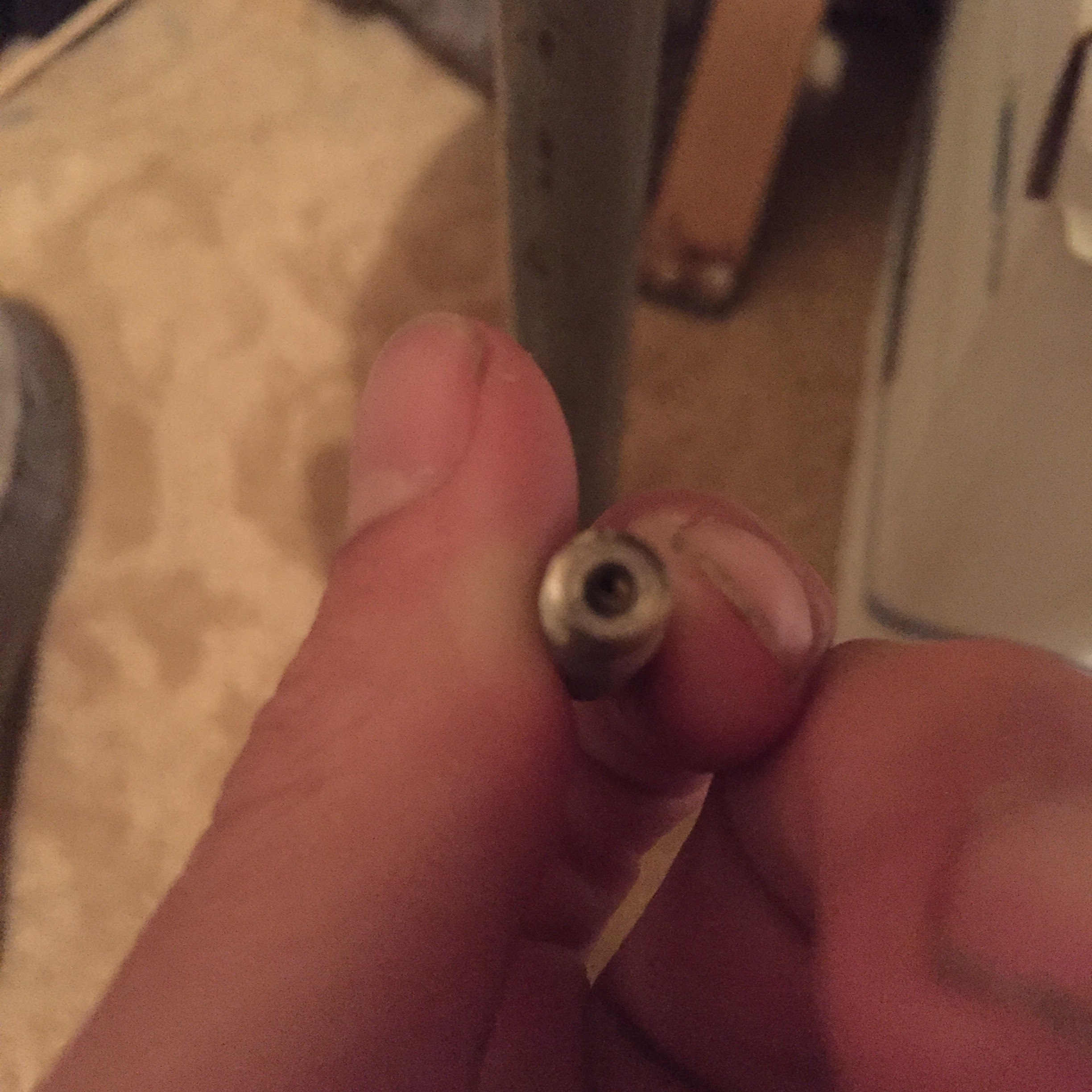

Clogged heatbreak
I’ve started using a filament oiler. No more clogs.
Plus, my prints smell like french fries.
Small (1cm^3) box with a piece of foam in it, and two holes. Route the filament through it, drop some oil in occasionally. I’m using vegetable oil because it’s what I had on hand, but at some point I’ll get some mineral oil or some three in one. Works like a hot damn.
