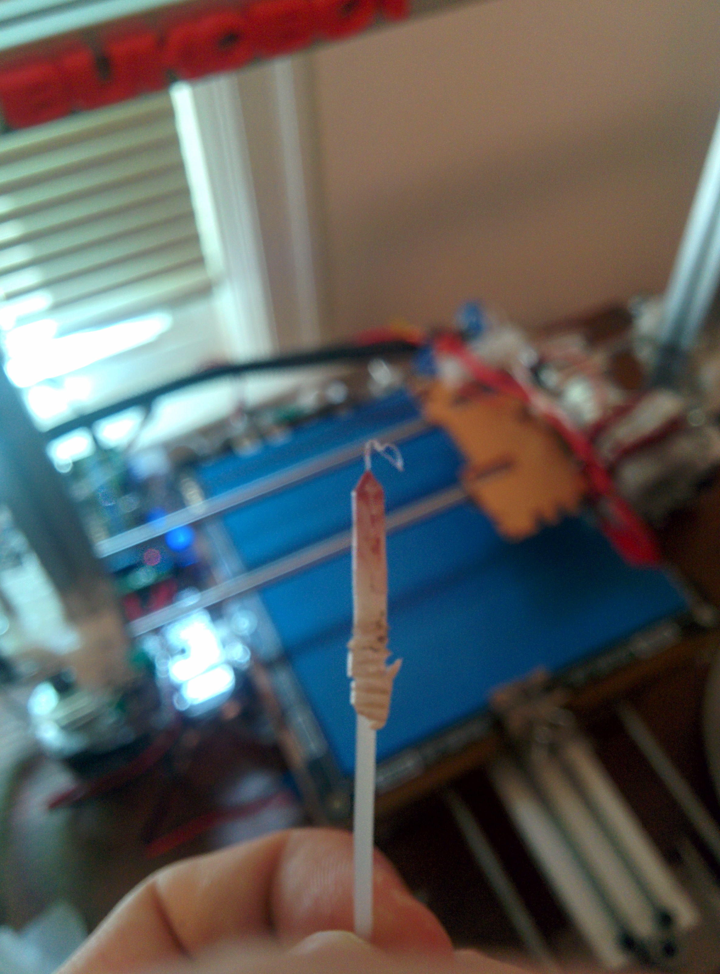

Got a 3mm barrel and an adjustable idler?
Got a 3mm barrel and an adjustable idler? But don’t have 3mm nylon to do a cold pull cleaning? Here’s proof that 1.75mm nylon works just fine too!

Yeah, I’ve used 1.75 to clean out a 3mm machine before. It doesn’t work as well as 3mm, but it can be done.
It definitely needs a manually tug on the filament to get the extruder to start pulling it out (with the idler locked all the way), but I did find the thinner filament diameter might squeeze by really tricky clogs. I only used 1.75 because I ran out of 3mm a while back.
Yeah, I’ve had ones where it helped to slip 1.75 past an obstruction, let it melt to form a plug as shown, then use that plug to grab contaminants from below and pull them out.
