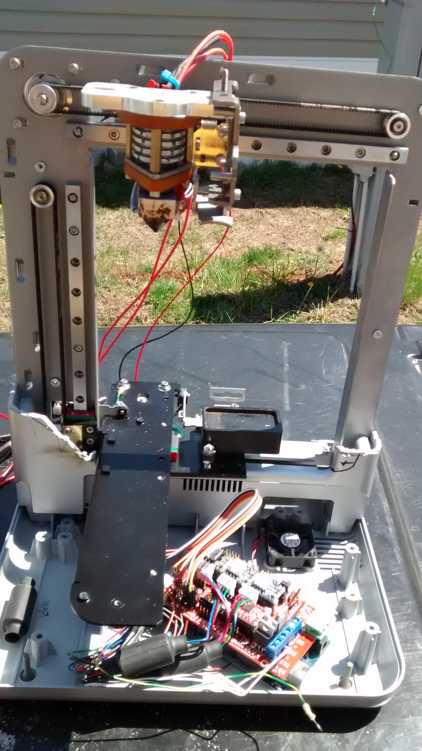

Got a broken cube off eBay and gutted it now building it with a
Got a broken cube off eBay and gutted it now building it with a ramps board and a budda nozzle coming together pretty good so far.
Nice little project, Great internal pics also :slight_smile:

the controller board was broken in it, and the extruder clicked and wouldnt heat up according to the ebay ad. The plastic was my doing I could/should have left it stock without cutting it up but bare metal frame looks better to me anyway. Once I hooked it up to the ramps board , which was easy since they break out all the axis in some nice headers, all I had to do was match up colors and plug in. I would like to reuse/ repurpose the touch screen but cant find much about it online.

no flex on the mounting rails they can handle that, the rails are the hwin 9mm ones mgn9.
working now on the Z homing. All my other printers have been home to Z- this one homes to Z+ and once the stepper timeout (in the firmware) it drops the Z down so I need to address that also. Its a learning experience but shouldn’t be to much to conquer.
The printer is moving and parsing gcode, and tuned the stepper drivers and quieted it down from the rattle trap that is sounded like, next up source a print bed surface and will call this one done
