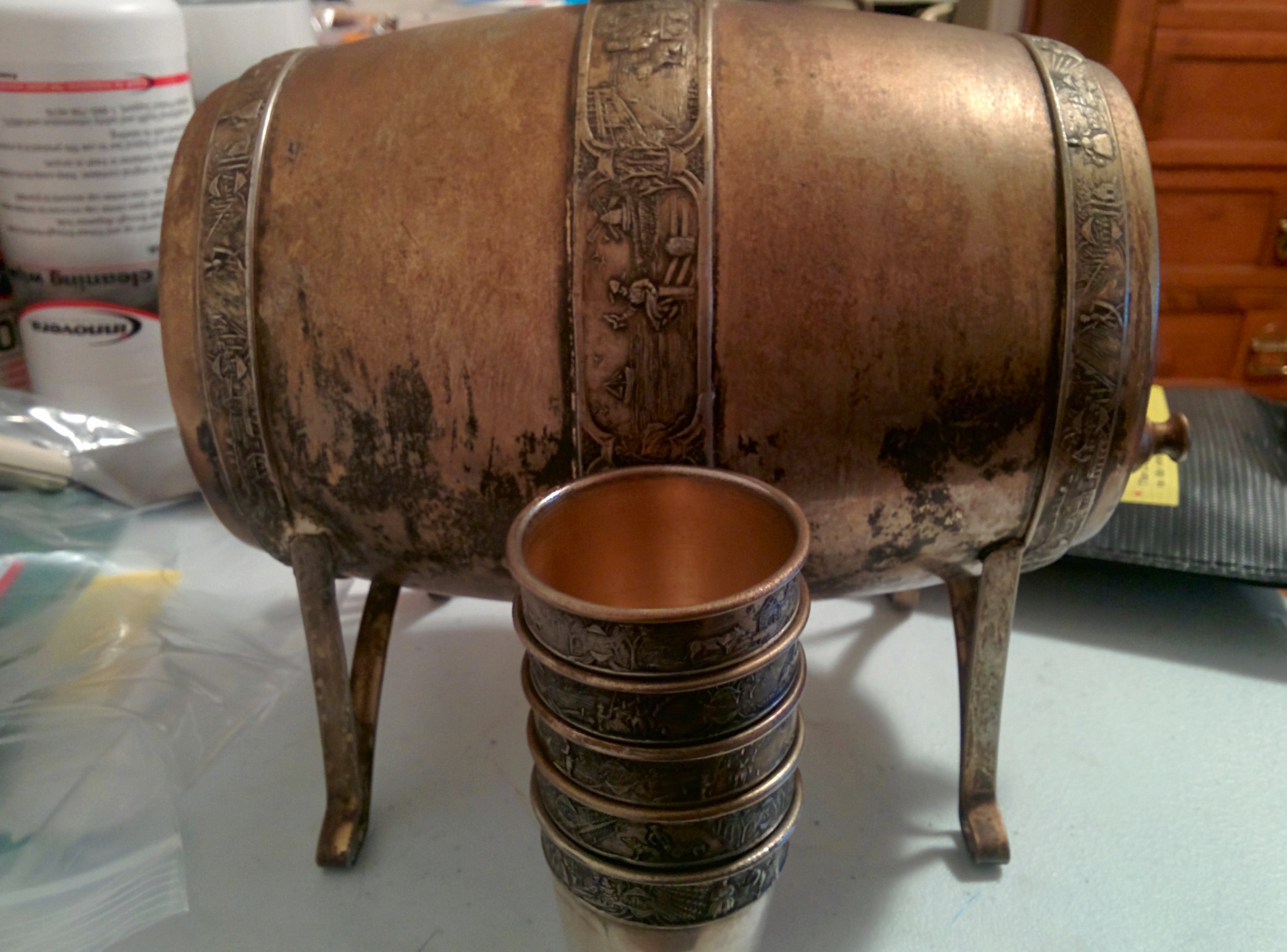

Got a fun project to make this bourbon barrel decanter spout for Charles Daugherty
Got a fun project to make this bourbon barrel decanter spout for @Charles_Daugherty . Made a test print in PLA to get the fitting right, just need to taper the cylinder to be flush throughout. Then I’ll add a smaller nozzle to limit flowrate.
Curious though, what material holds up against bourbon? Let alone, is it a good idea at all? I plan to print the final one in PETT, assuming that would work. I’d also imagine that PLA + bourbon do not mix.
This calls for a test, to which I’ll update on later.
I had originally brought up the concern of bacterial build-up over time between layers, to which the owner responded “Naw, the alcohol will eat right through that shit.”

Lost PLA then cast?
Why wouldn’t PLA + Burbon last? PLA is resistant to most solvents, including alcohol.
Really? I wouldn’t have figured due to the corn origin of PLA. Looks like I’m mistaken then!
@Ben_Van_Den_Broeck , I’m not able to confirm my claims. There seems to be very very little data about PLA out and available…no idea why.
If it’s going to be in contact with beverages, I would use PP and preferably “food grade”. It seems the German reprap has it in stock (expensive?). I’ve been looking for regular PP but can’t find it (haven’t looked hard though…). That said, most filament has a “grey” supply/production chain, not to say composition (cross contaminants?) - at least to my understanding. Were did you found PETT? It may suit my needs, especially if I can print it crystal clear (or close)…
@Nuno_Lourenco There is clear PETT available from Taulman, I also got my blue PETT there too. Works well, just print relatively slowly.
@Ben_Van_Den_Broeck thanks for the info!
