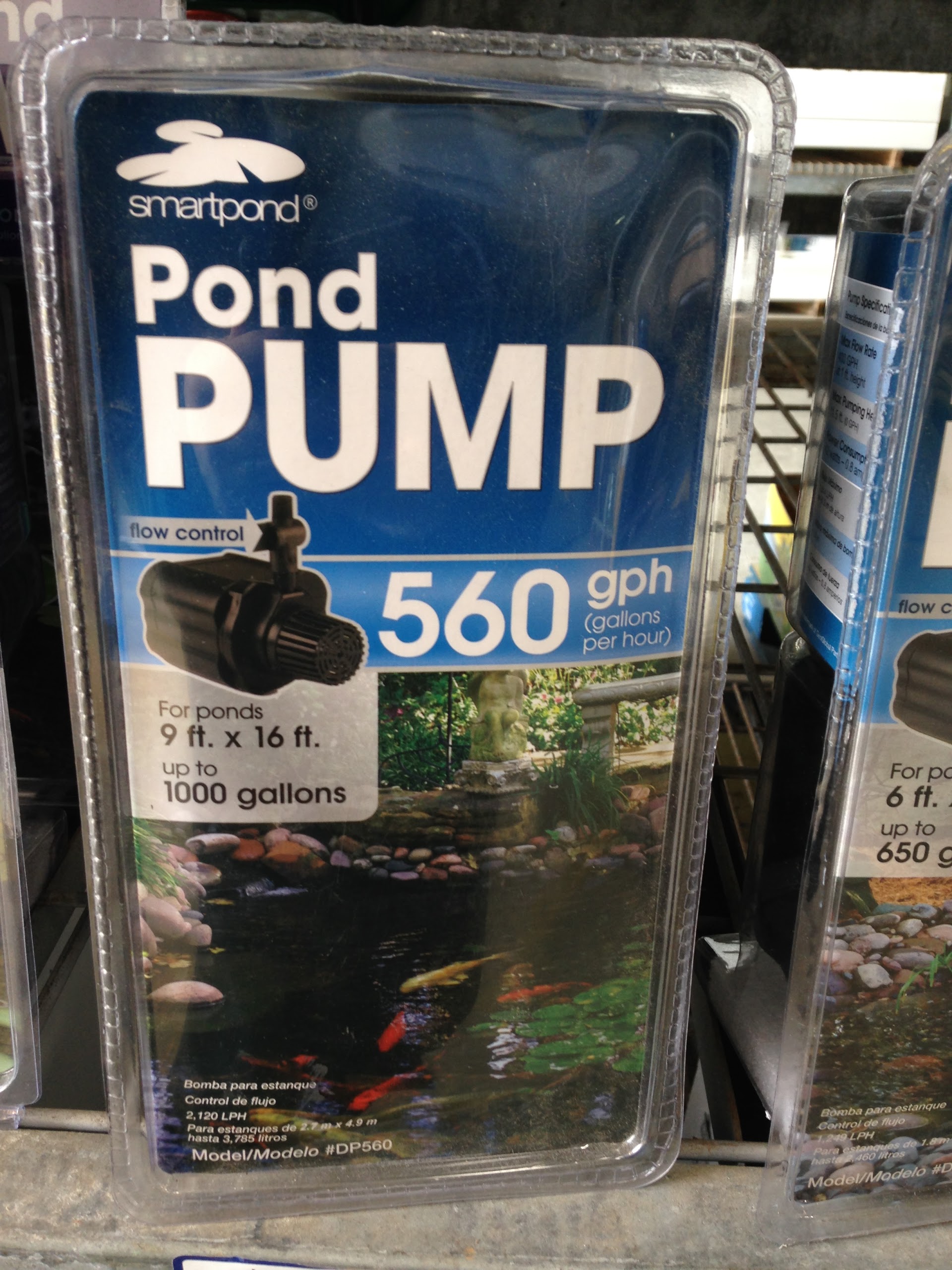

Got a replacement pump for my stock pump that just died (lasted all of
Got a replacement pump for my stock pump that just died (lasted all of 3 weeks of fairly light use).
Got a pond pump from Lowes, same approximate output as the stock one, hopefully more reliable.
Had to get a couple fitting adapters (1/2" FIP x 3/8" FIP reducer coupling and 1/2" ID x 3/4" MIP hose barb) to size down to fit the laser inlet hose.
It’s loud compared to the stock pump, which was whisper-quiet, but if it proves reliable I can put up with a little noise.
