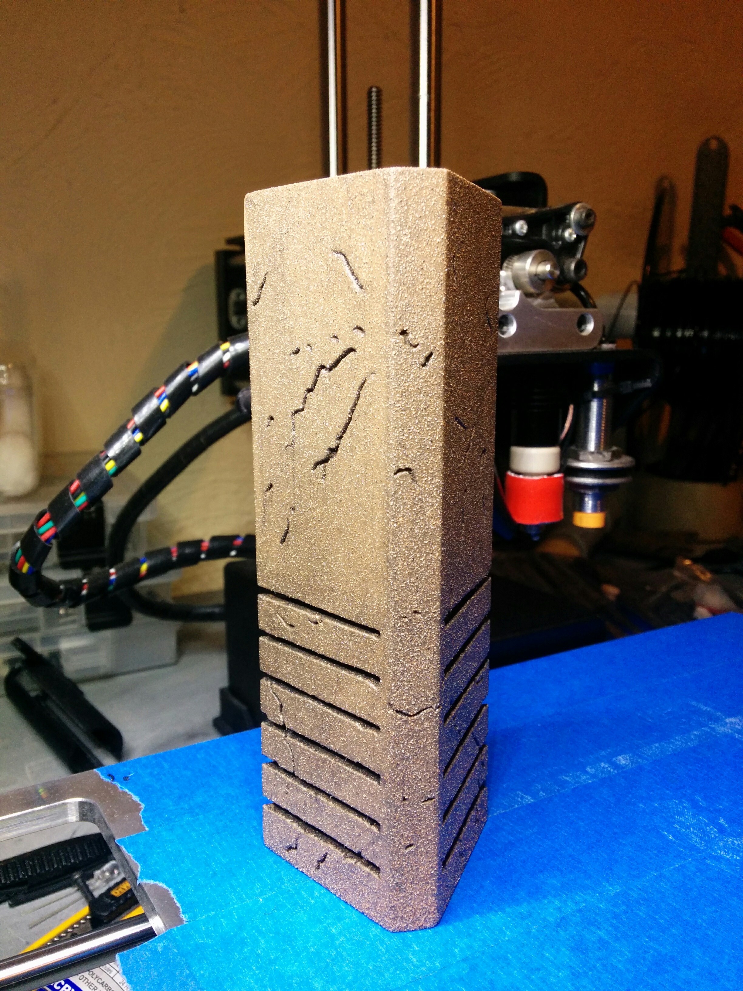

Got inspired by the awesome "Fifth Element" stones that Jason Clark ​​ did,
Got inspired by the awesome “Fifth Element” stones that @Jason_Clark ​​ did, and wanted to experiment with some finish techniques as well as printing them in one piece laying on their side (to make use of my newly extended PrintrBot bed).
This print was at 50% scale for the sake of speed, and as I’m quite lazy I painted it entirely with Rustoleum sprays from the Home Depot…but all in all I think it came out pretty well and has me thinking about doing a full run closer to full size (probably ~80% scale).
Here’s the Thingiverse page for anyone interested: http://www.thingiverse.com/thing:1012118
OMG this is beautiful thank you for the post just found my next set of prints! which paints did you use because this looks spot on and I want too get the same I assume a textured spray?
The base color is “Satin Nutmeg”, and then “Burnt Umber” and “Desert Bisque” texture sprays. I’ll add a picture of the cans to the post if you want to buy the same ones.
Most of the color is coming from the Nutmeg, the two texture sprays were put on very lightly. I sprayed it from like 2 feet away to just get a little touch on it (I didn’t want to much texture and lose the details).

that looks cool as hell is it possible to mimic weathering for age?
