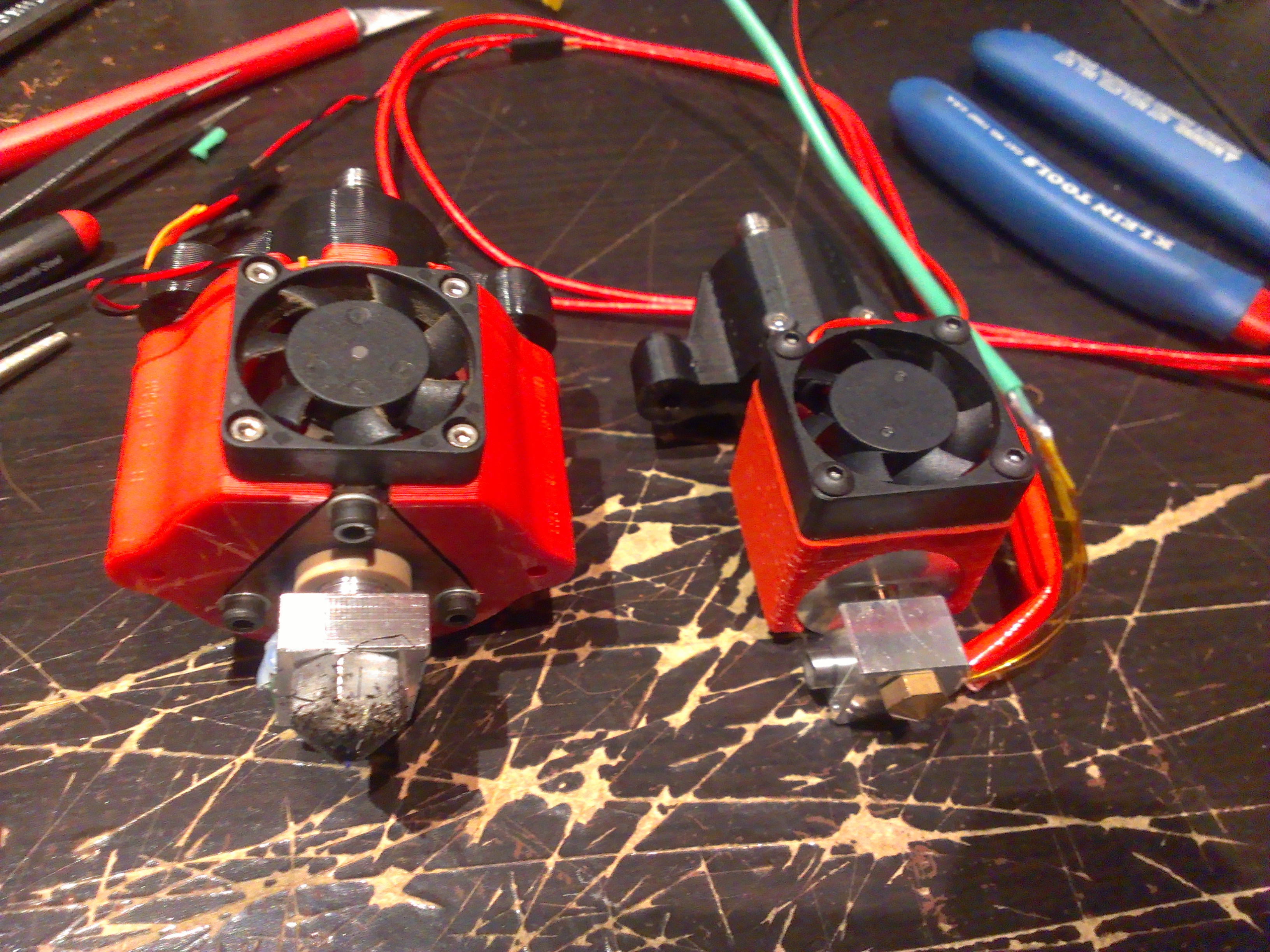

Got my E3Dv4 installed funny how much it looks like my buddhaschnoz setup
Works great, far less drool than buddha. I went from 6 to 3mm retracts with abs. no blobs on perimeter starts.

The shroud I designed in freecad with python. I wanted the outgoing air going away from the print. I was sure this thing would melt, but it has run for 100s of hours @ around 240c.
