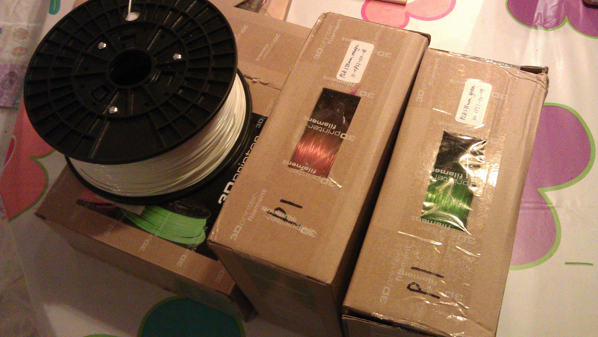

Got my first order of filament. Will start testing tonight. It will be interesting to see what it is I’ve bought.
What type of filament (ABS/PLA, 1.75/3mm) and where’d you purchase from?
PLA 1.75mm and I ordered it her. http://www.3d-printer-filament.com/product-overview/pla.html

I have measured the diameter and it ranges from 1.66-1.74. Dragging it between my fingers I can clearly feel the diameter change. No inclusions what I can see. I’ve printed some test objects and after changing the dimension stetting from 1.75 to 1.70 it looks ok. I haven’t played with any other settings yet. I’ve only printed 300g of faberdashery’s white filament before this so that is what I have to compare it to. The problems I see in the prints are the same as with the faberdashery so I guess I have some more calibration to to. Skeinforge has many options to try;)
