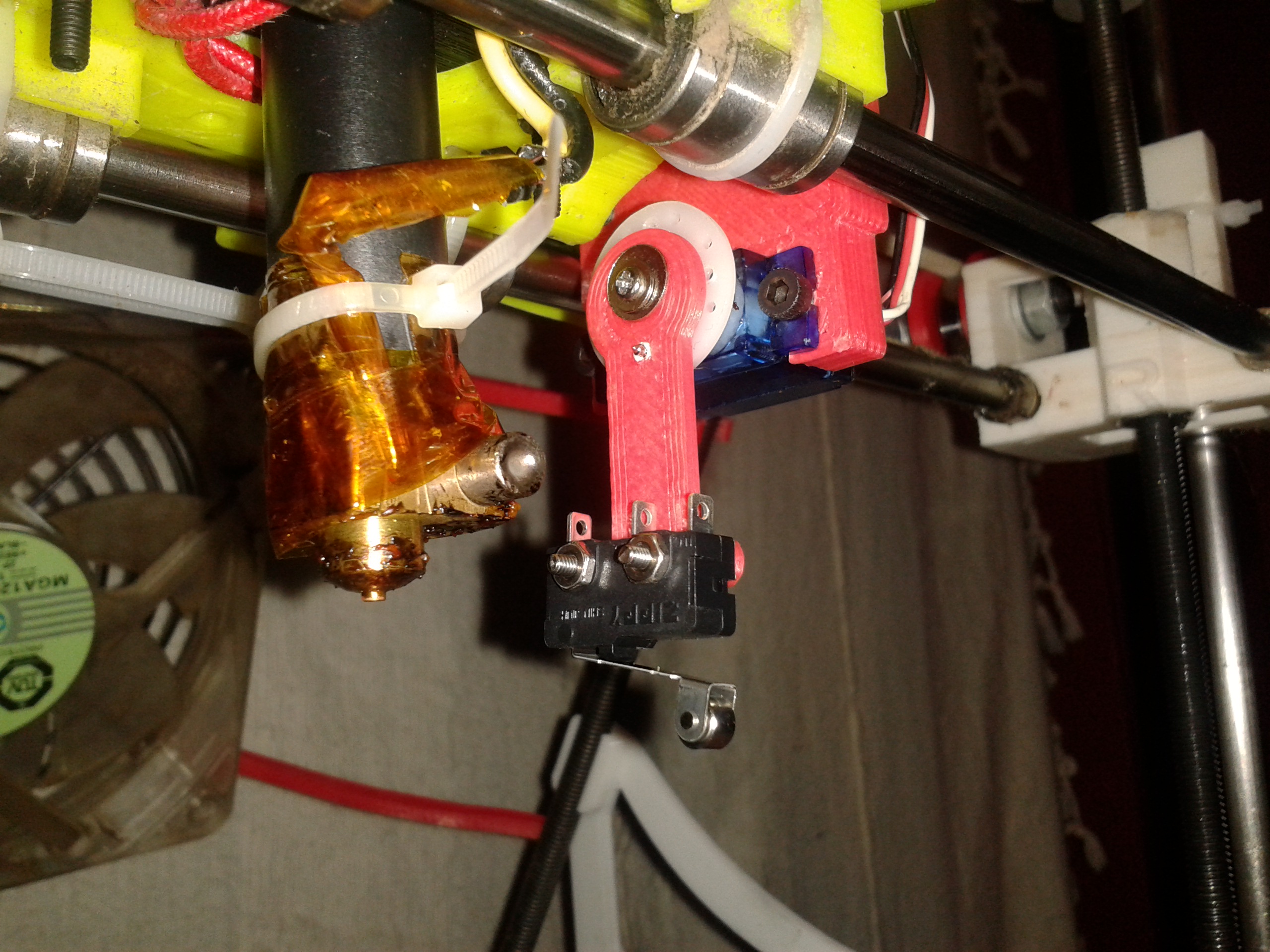

Got my new hotend installed (last one finally died) and setting up a z
Got my new hotend installed (last one finally died) and setting up a z probe as well.
I will most likely replace this nozzle with a Merlin or an E3D hot end. Any preferences on one over the other?

Thanks @Tom_Oyvind_Hogstad and @ThantiK looks like it’s the E3D.
Any idea ware the zprobe section is in repetier firmware I don’t know if they took it out our what but it’s not ware they said it is and as far as I know I have there latest firmware.

Found the option for z-probing its in the development repo on git hub.
Going to be a big make over to my I2 ill post pic with my upgrades.
