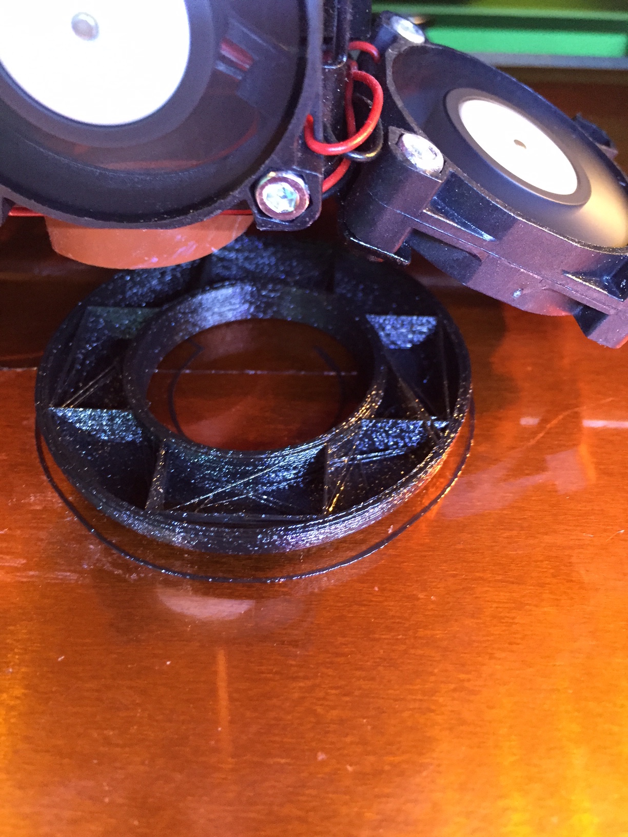

Got my NinjaFlex tires working! Here is one in-progress to show the infill.
Got my NinjaFlex tires working! Here is one in-progress to show the infill. I had some bridging problems when I did concentric layers on the shell, but switched to parallel lines and it is great. 4% infill was enough to support the shell while still leaving the tires flexible.
Nice. Great to see one in progress, what slicer are you using?
CraftWare. It really was a pain to get the ninjaflex right, but now it is consistent and the tires are absolutely perfect. The infill gives just enough bridging while still keeping the tires squishy.
