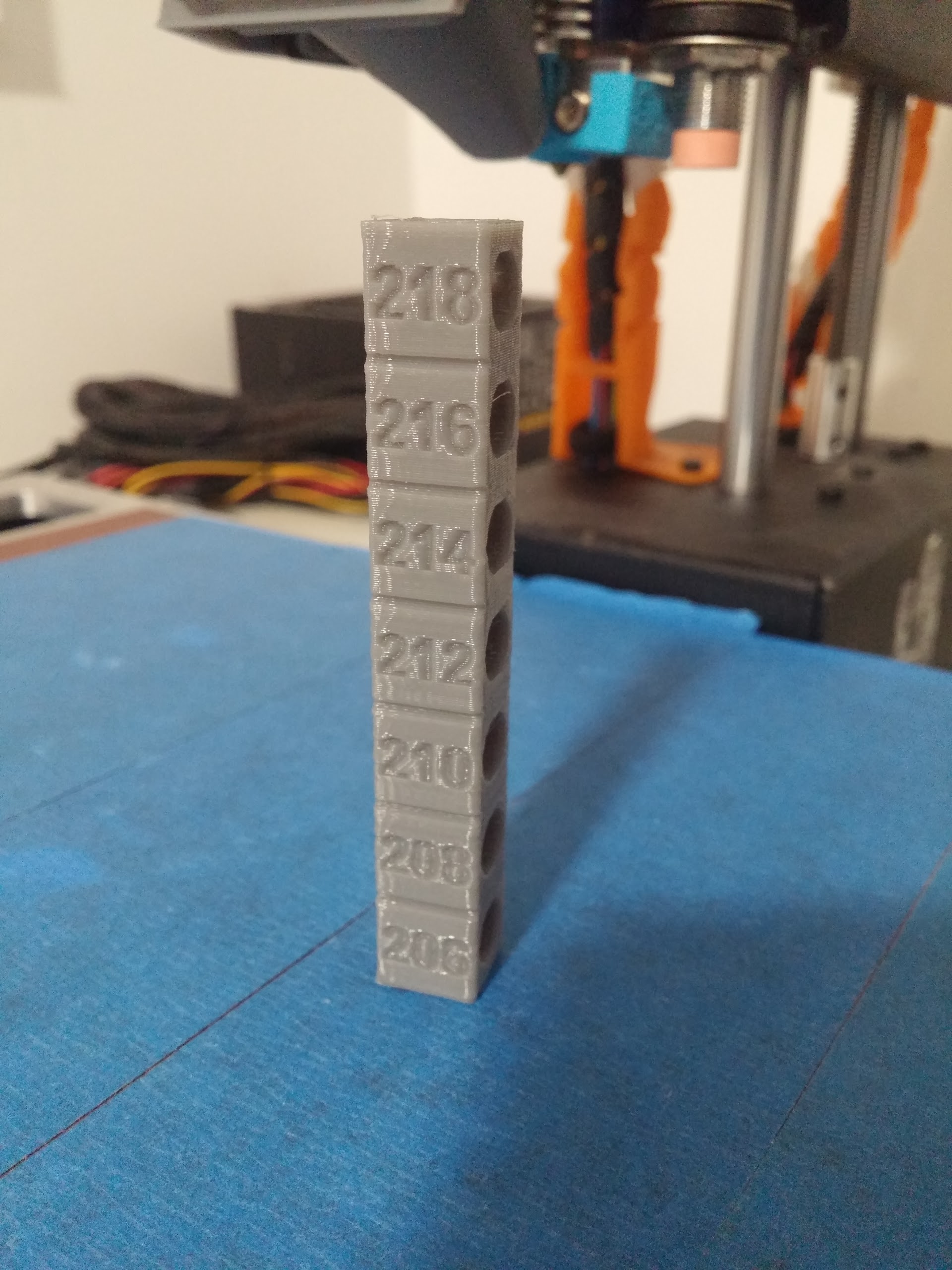

Got my Printrbot up and running with its new firmware, did a PID tune,
Got my Printrbot up and running with its new firmware, did a PID tune, and am now calibrating filament temp with this cooling tower. Looking pretty good! Had no idea cura allowed you to change temps at different heights, very usefull infošŸ‘
Glad to see you got your printer up and running :slight_smile:
You can change temps in cura? I had to change manually in the gcode file.
@Geoffrey_Forest you go to the plugins tab, then it should have one called TweakAtZ, gives you the ability to change alot of settings depending on z height, its really usefull only found it today
