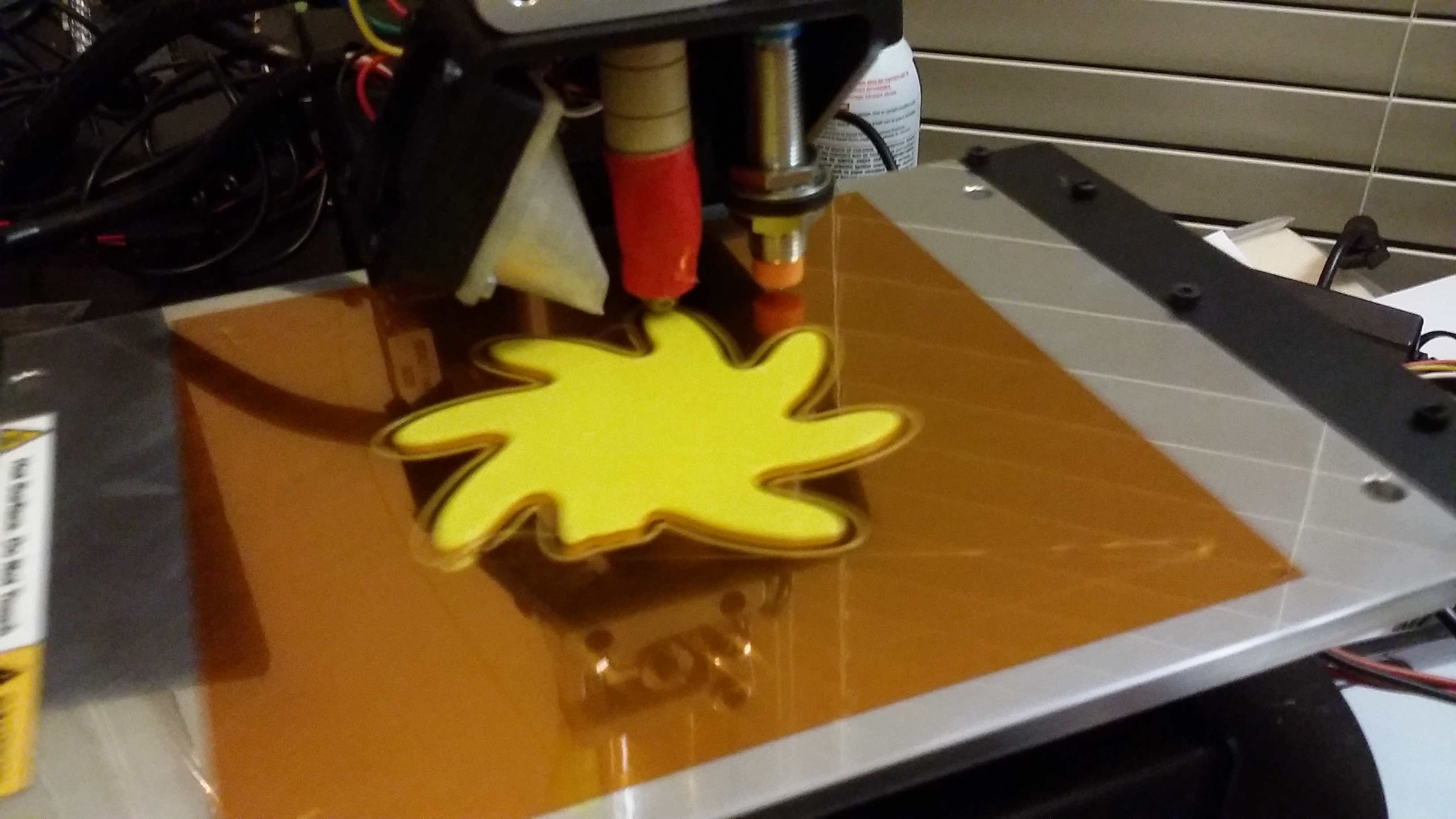

Got my Rev f board heated bed upgrade today for my printrbot simple metal.
Got my Rev f board heated bed upgrade today for my printrbot simple metal. I can now print without blue tape. The print quality has been fantastic. Now without the curling, I really cannot sing a better tune for Printrbot.
Can the document be improved? Probably if you want to make it fool proof. But if even a layman non hardware guy like me can follow some instructions, I think this printer is a sure win. In fact I want to petition the a name change for the simple metal. Let’s called it ForTheWin printrbot. It’s that surefire. :grinning:

Did you just screw the heated plate to the aluminum bed? Or did you use some sort of epoxy or thermal paste between them?
I had issues with my Jr’s heated bed until I used a thermal epoxy to put the two pieces together. How long does your bed take to get up to 80° or 100° C?
I follow the exact instructions on Printrbot website and have it installed with only screwing the bed to the plate. It takes no longer than 8 minutes to heat to 70. I usually preheat the bed when I am slicing stuff in Cura.
